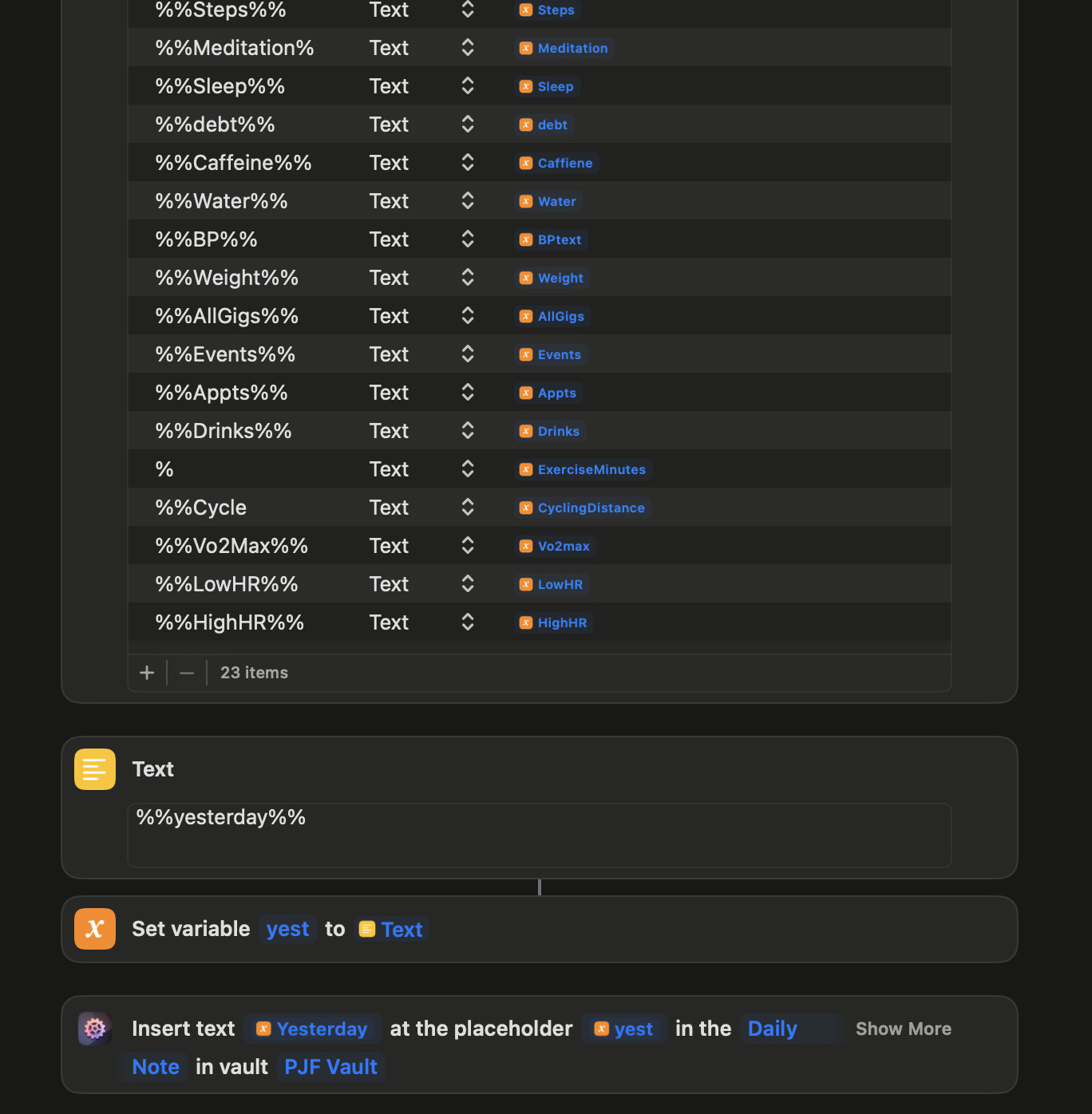

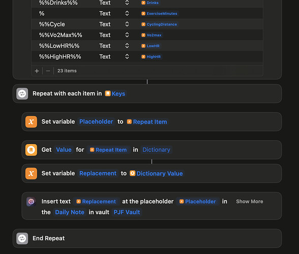

So I go, Create Daily Note in value PJF
Then I have a big dictionary that sets up all my %%Steps%% stuff mapping it to variables I have pulled together earlier in the script.
Then repeat with each item in Keys
Insert test Replacement at the placeholder placeholder in the Daily Note in vault PJF
So it is the insert text that is struggling. And it may be because I am giving it bad data…

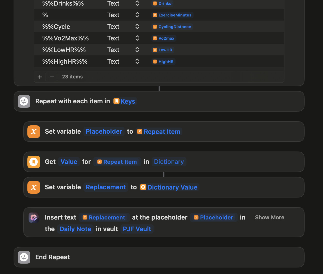

If I just do the one substitution as shown in the above picture it works. If I do it like the following picture… then it all goes into the front matter

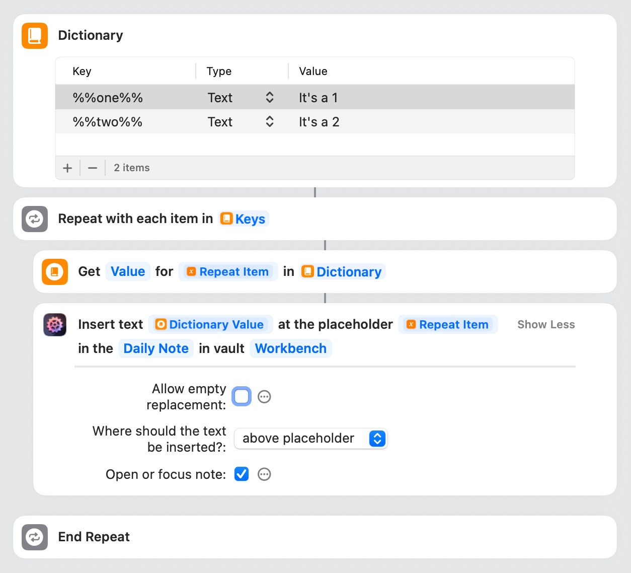

I’ve tried to reproduce the issue and came up w/ that stripped-down test case:
This is the whole of my current daily note:
tags:
### Today is Tuesday, 2025-05-23
%%one%%
%%two%%
And that works fine.
So it is the insert text that is struggling. And it may be because I am giving it bad data… […] If I do it like the following picture… then it all goes into the front matter
You might be right, and there’s something about your data. Hard to tell from afar, especially w/o access to said data and your DN template. So let me throw some random questions at you in the hopes to hit jackpot
Could it be that some of the replacements are triple hyphens which Obsidian then interprets as YAML boundaries?
Some of the keys look weird (%, %%Cycle), did Shortcuts cut them off in the display or are they supposed to look like that?
About 8000 changes and its working again. I am not sure how I broke it. And am even less sure how I fixed it. Thank you for humoring me.
