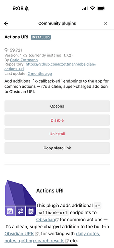

Yep, here is a screenshot of it installed
Cool, thanks. (The iCloud video wouldn’t download for me earlier, it just sat there showing the spinner and doing nothing. iCloud being iCloud, I guess.)
So, Obsidian is supposed to hand the incoming calls from AFO to Actions URI, but sometimes it doesn’t for no apparent reason. This can be a bit tricky to debug from afar, so I’m just going to list a couple of steps here. Please try them one at a time, after each step run the onboarding again.
