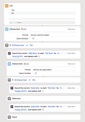

I’m trying to set up a day evaluation shortcut, but it doesn’t work (and in a quite peculiar way).
I have a daily note with the following YAML-code:
created: 2024-05-28
tags:
  - daily_note
exercises: "%%exe_ph%%"
yoga: "%%yoga_ph%%"
swimming: "%%swimming_ph%%"
cycling: "%%cycle_ph%%"
diverse: "%%div_ph%%"
meditation: "%%meditation_ph%%"
drinking: "%%drinking_ph%%"
smoking: "%%smoking_ph%%"
classes: "%%classes_ph%%"
drawing: "%%drawing_ph%%"
mood: %%mood_ph%%
And I try to substitute placeholders for “1” and “0” by using “choose from list”, “if…else…” and “search and replace”. All of the main moves are present in the screenshot below.
My problem is roughly the following: if I select yes to the first question, than a lot of false positives happen (I press “no” on a question down the line, yet I still get “1” in a property field, and vice versa. Can you please take a look, I attach the link to the shortcut here.
Thanks in advance,
Cheers,
K

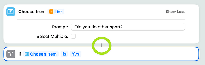

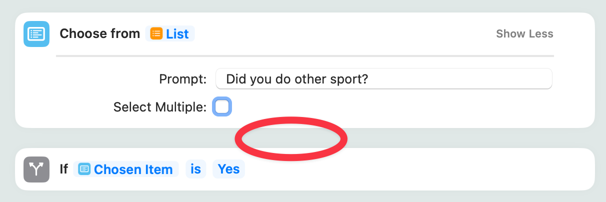

The video helped to understand the problem, and once I knew what I was looking for, it was easy to spot.
The discrepancy (“false positive”) happens after answering “Did you do other sport?”, right? This is because the If action following that Choose from List block is not using that block’s result but an earlier one. It’s (hardly) noticeable by the missing connector between the two actions:

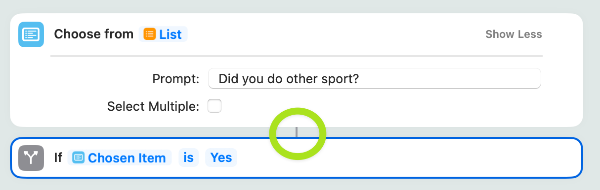

Once you select the right variable/result, the connector will appear:
HTH!
