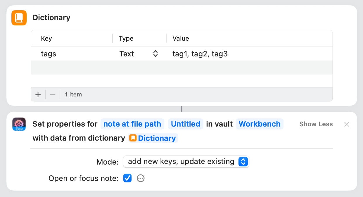

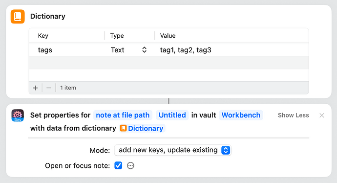

And if you use Actions For Obsidian, and are used to set the tags value in your properties dictionary to a simple comma-separated string (“tag1, tag2, tag3”) and use them with Set Note Properties, like so:
… then Obsidian 1.9 will no longer recognize these tags as tags because the action passes any key/value pairs to Obsidian as they are, so the resulting YAML front matter looks like this:
tags: tag1, tag2, tag3
… but again, Obsidian 1.9 expects it to look like this:

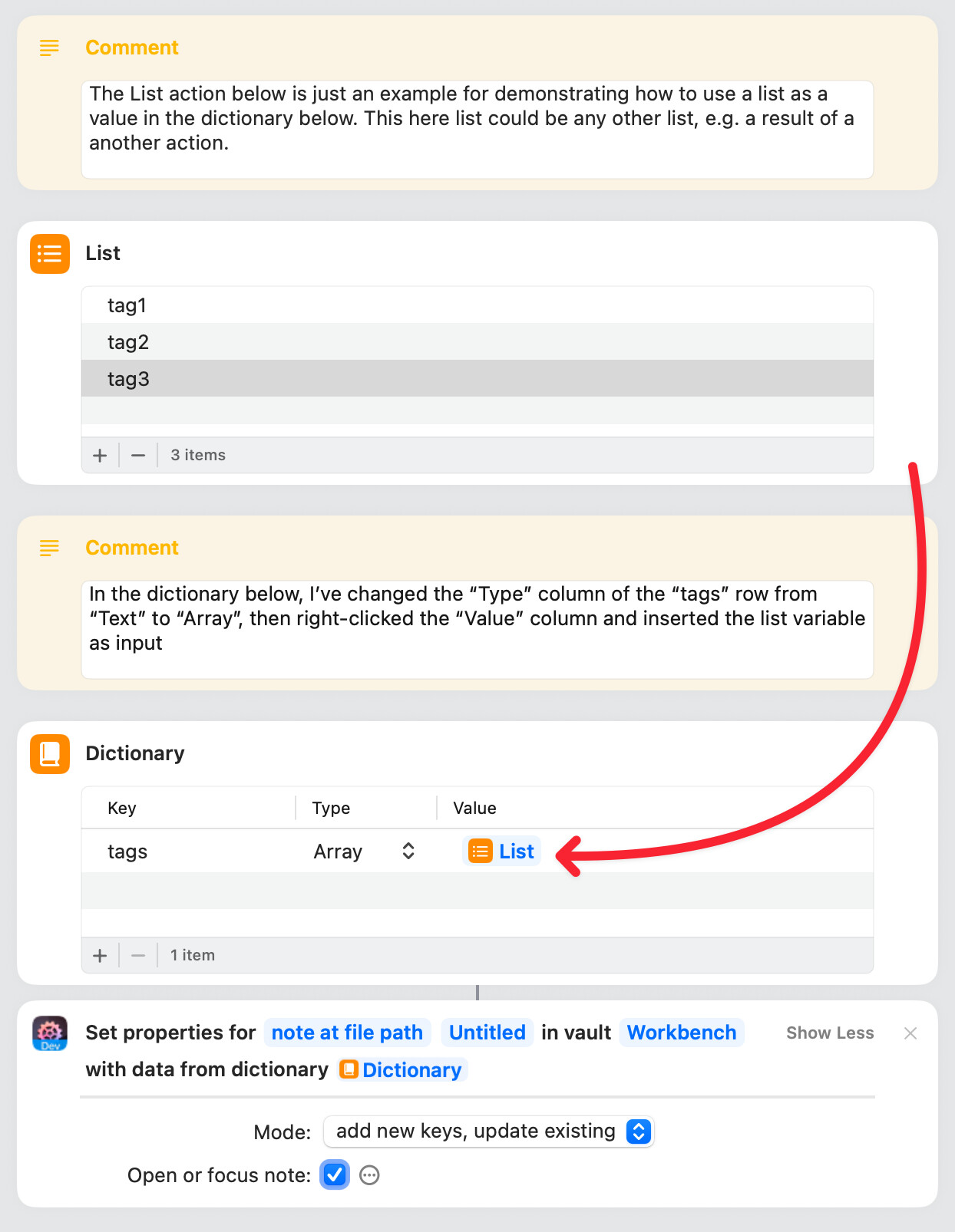

What to change: Option 1 – Change your Shortcuts workflows
In your workflow, collect your tags as a list. You could do that by defining a fixed list (as I did in the example below), or by choosing several items from a fixed list using a Choose from List action.
Then, when defining the input dictionary for the Set Note Properties action, set the tags row to type “Array”, and use that list as the key’s value (by right-clicking the “Value” column).
Pass the dictionary into Set Note Properties, and Obsidian will be happy because it receives your tags in the right format.
