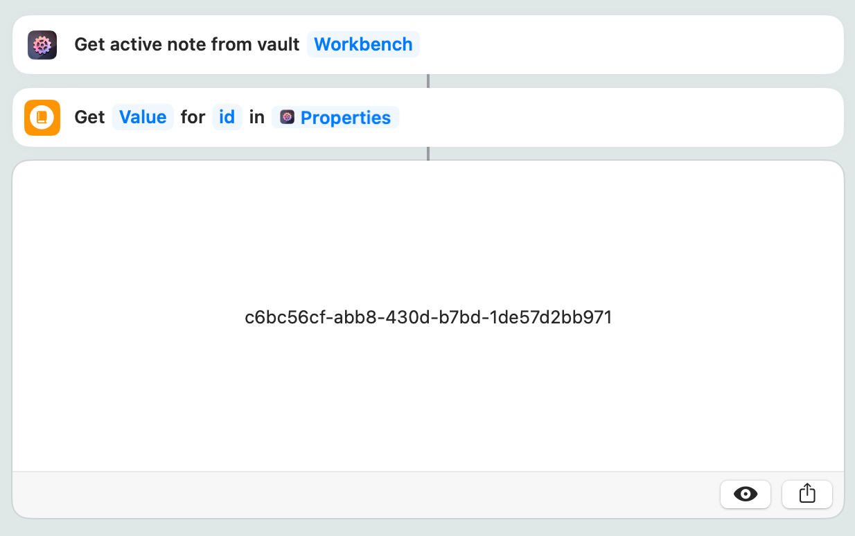

Now, here’s the answer. The note object contains the file properties already, so using Get Active Note should give you access to everything you’ll need:

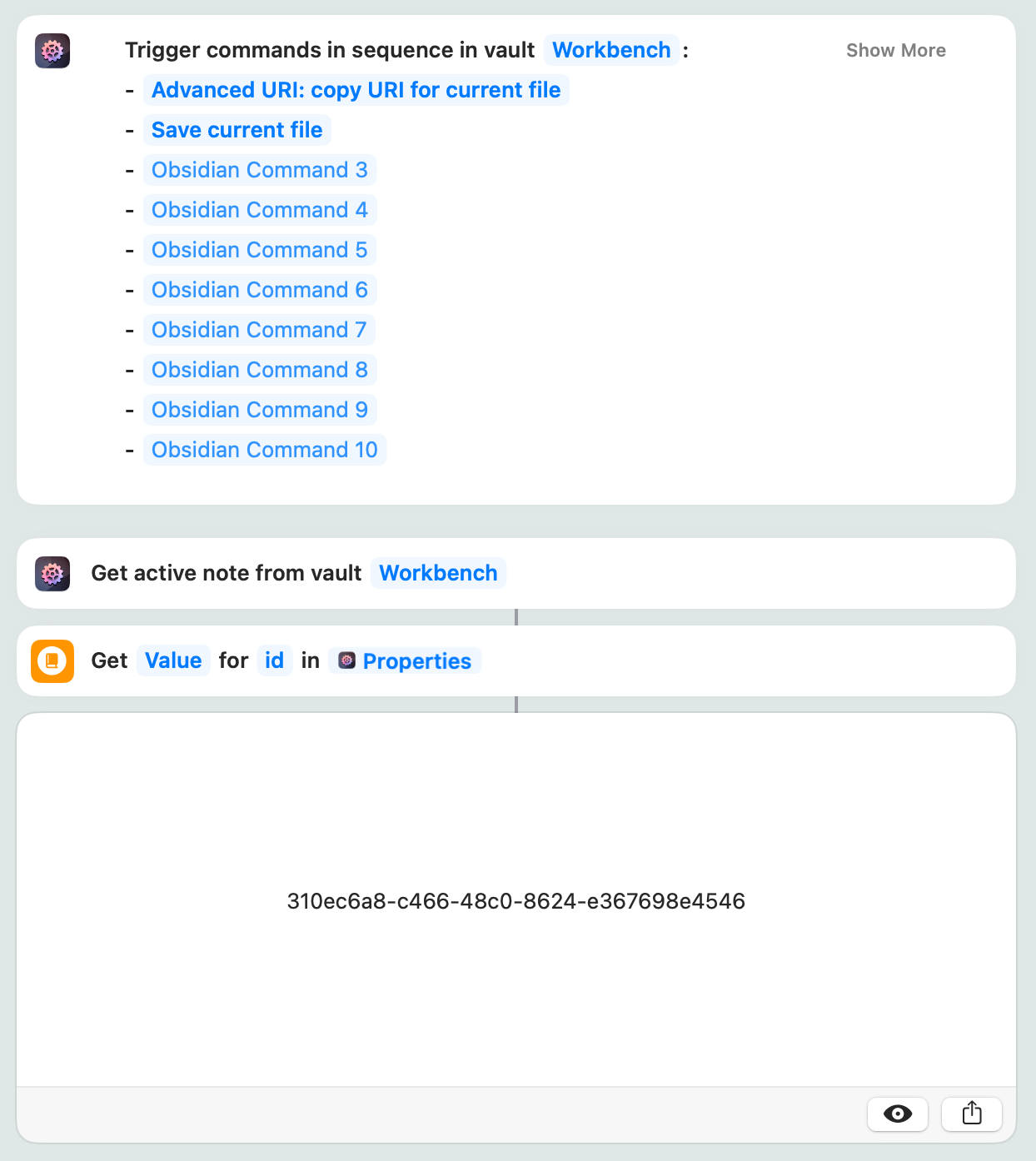

That works when a note already has an id property. When it doesn’t have an id property, I can use Trigger Command for “Advanced URI: Copy URI for current file” that does assign an id property with a generated UUID as its value (and copy it to the clipboard).
However, after the command, I’m not getting the id property value, even if I use Get Active Note again, although I guess I could extract it from the the Advanced URI command in the clipboard, but I shouldn’t have to do that.
I thought maybe I need to wait for a little first before the note is updated so I tried 3 seconds but that didn’t make any difference.
How do I get a newly-assigned id property after issuing the Advanced URI command?
Ah, now I understand. Advanced URI doesn’t seem to save the file after inserting the UUID, so the file properties aren’t updated. Explicitly saving the file after applying the Advanced URI command does the trick.

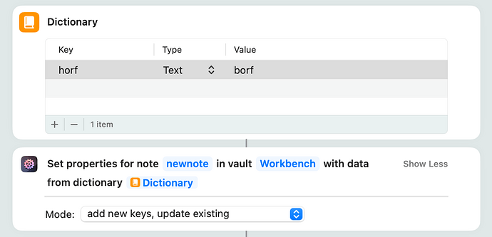

The Set Note Properties action also requires a File Path, which I suppose you can get the File Path in the active Note. If I create a Dictionary for Set Note Properties in some note, would I then have to Save current file so the changes are stored in Obsidian?

In regards to updating the file properties, Set Note Properties will auto-save the note so the changes are correctly propagated. So this would suffice:
Thanks for the clarification. It’s important to know that Set Note Properties does save the changes in the note, and the example is very helpful.
