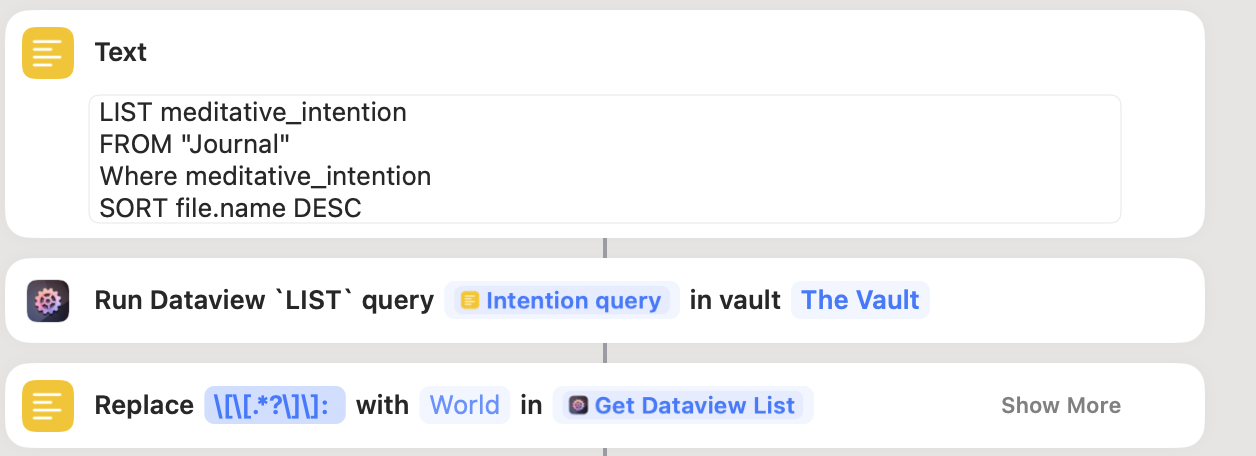

And here’s the workaround I use now.
Hope it helps :slight_smile:

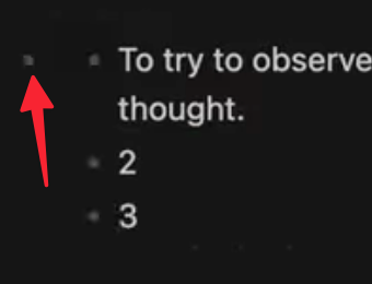

Thanks for the addendum. I can replicate it, hooray! The issue only arises when more than one meditation entry is found in a single file. I noticed that in your video, there was a double bullet point, while in my simple test case there wasn’t. When I added a second medidation entry to one of the files, the JSON error popped up.
The reason is that the LIST result returned by Dataview returns a list, where each line in the list represents the results from a single file. When there is more than one entry for a file, the line contains a list of entries; when there is just one entry, it’s just one entry. Those lines are different in terms of structure, and AFO falls on its face.

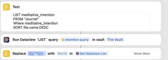

For now I come up with a workaround with a replace text action:
At least for my case there is no noticeable difference to the “no id” query.
Provided the level of specificity of this bug, maybe you can just suggest this workaround in the action’s description.

I hope you don’t mind me suggesting it: Your regex it’s a bit loose for my taste (it’ll remove every wikilink followed by a colon), I’d personally change it to ^.+?: which removes everything from the beginning of each line up to and including the first colon.
Thanks for the suggestion!
