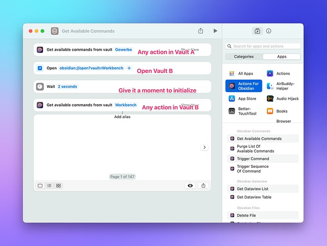

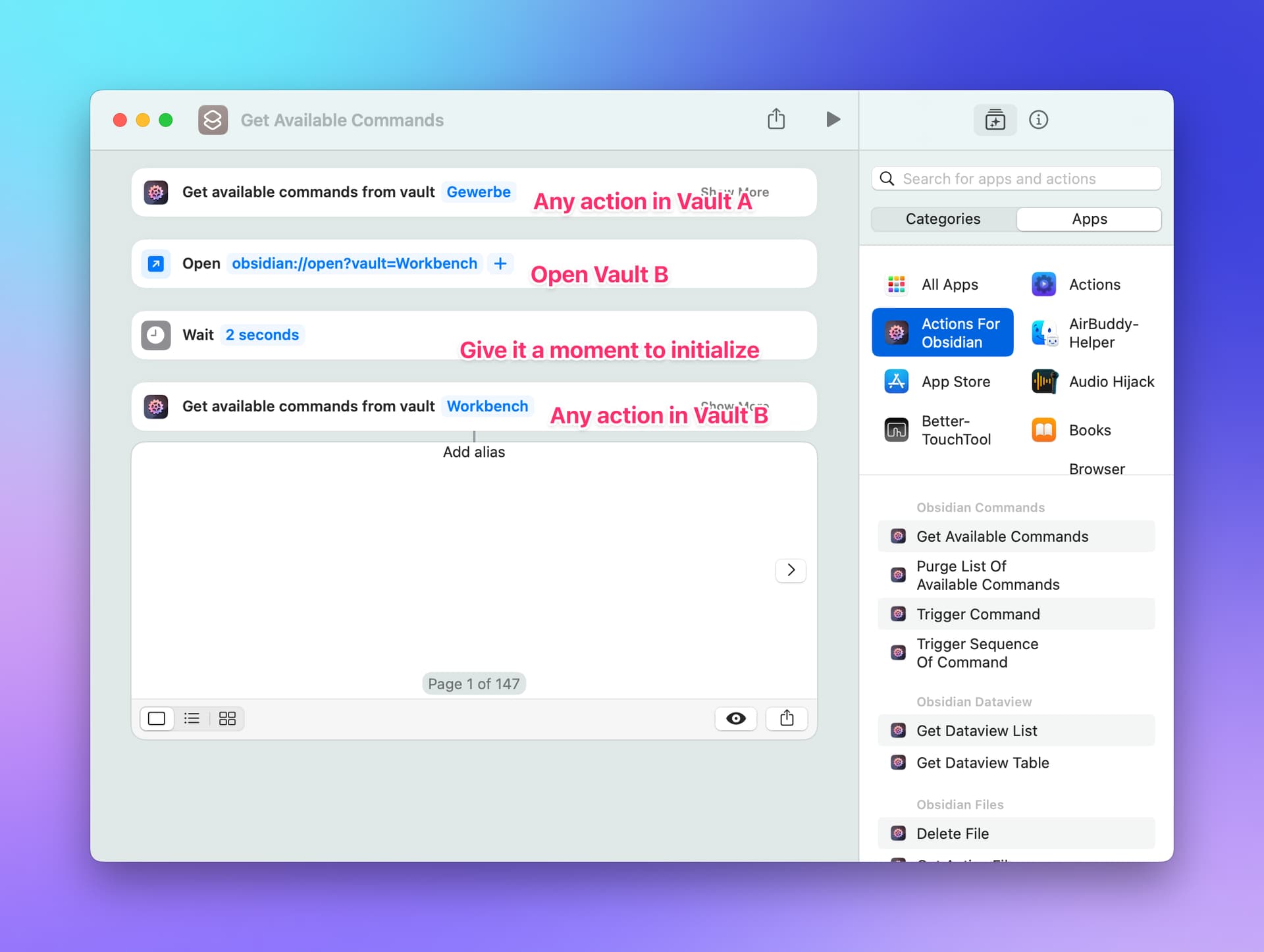

Workaround: As long as you’ve linked both vaults to AFO, you can use a built-in Open URLs action to open vault B, wait a second or two for it to finish initializing, then work with vault B. It’s not pretty, but it works (until, hopefully, Obsidian fixes that issue).
