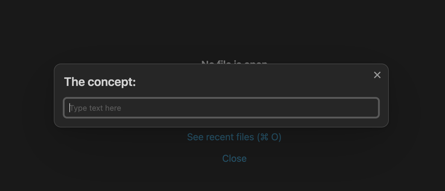

Here how the prompt looks like in Obsidian:

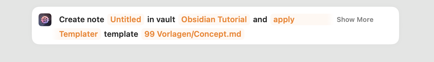

Maybe I don’t get the issue right, but with this AFO call Templater asked for the title:
@czottmann – Thanks for the insight, was wondering about passing input through but good to understand that “What happens in Templater stays in Templater”…
@leif – This is it! So simple that it could be a bit embarrassing to not have thought about it myself. Thanks so much, this takes my AfO use def to a new level. Now I just need to find the “Resolved” check box :wink:
