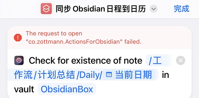

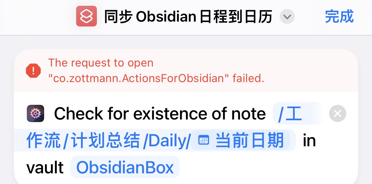

I try to use ios automation to execute shortcuts every day, but I got this error when iphone locked. Could you help suggest how can I resolve it?
Time-based automation won’t work, I’m afraid — due to the type of Obsidian API, the device needs to be unlocked. Basically, the API that Obsidian is providing is URL-based, i.e. meaning Actions for Obsidian asks iOS to open a obsidian:// URL, which iOS sends to Obsidian, and Obsidian sends it return values back by asking iOS to open a actions-for-obsidian:// URL. But when the device is locked, the apps can’t be opened, and so the automation fails.
I don’t like it, either, please believe me. But there’s not much I can do about that, I have to work with what’s made available to us developers. Sorry.
