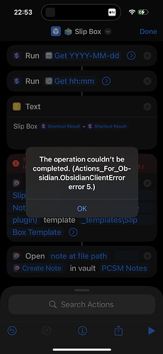

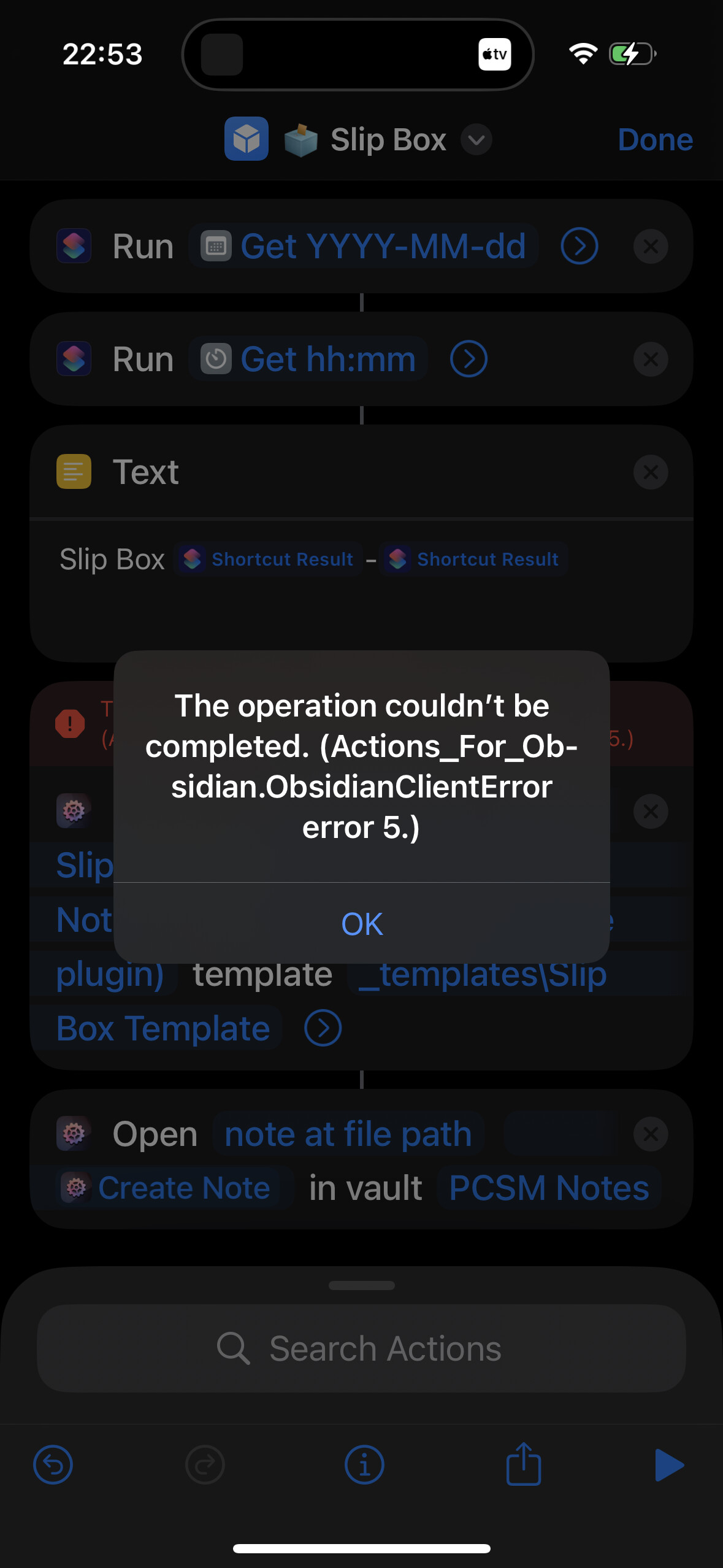

My shortcuts that use Actions have broken since I updated to iOS 18.0. The attached shortcut actually does create the note and opens the note in Obsidian but the shortcut hangs until I return to it, when it then shows the error message.
Edit: I have Actions For Obsidian 2024.2.1.
