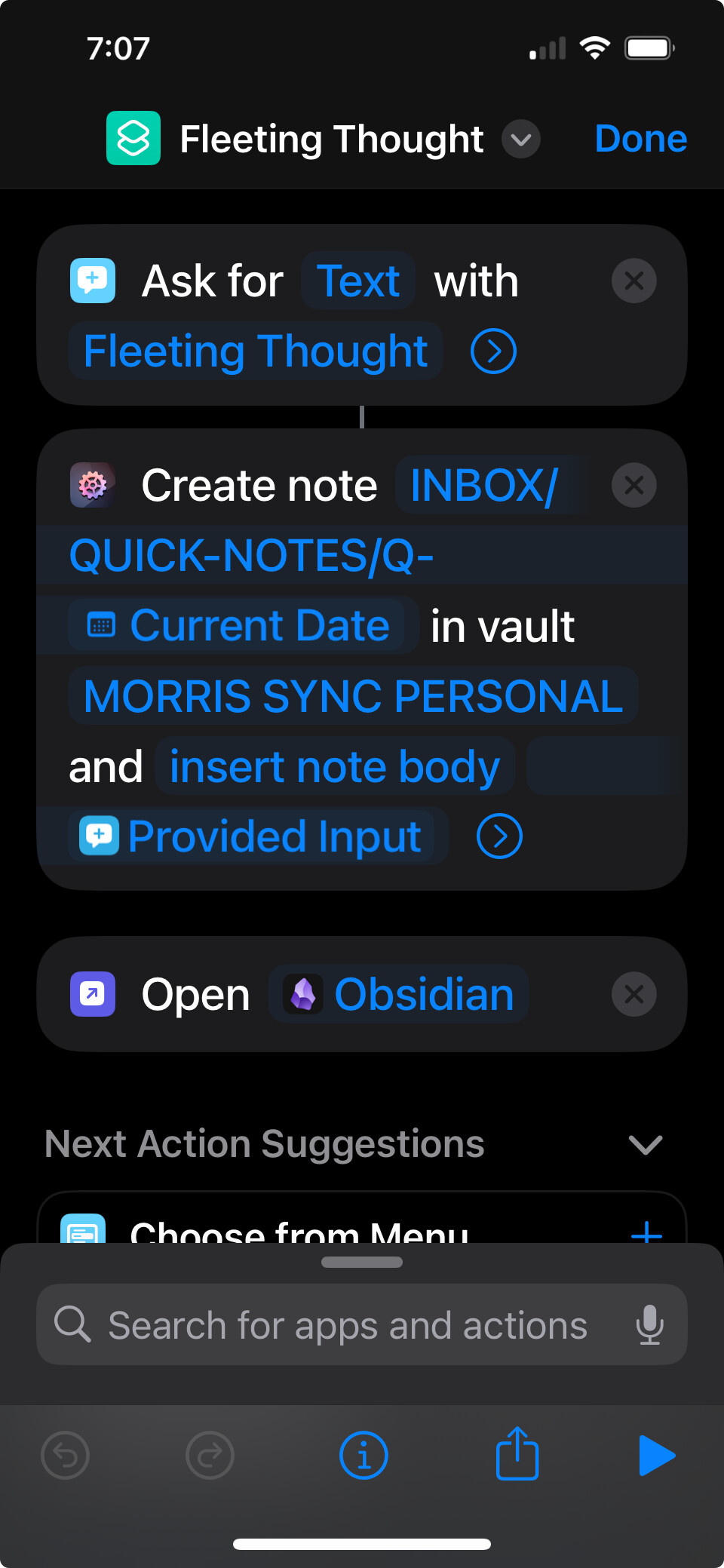

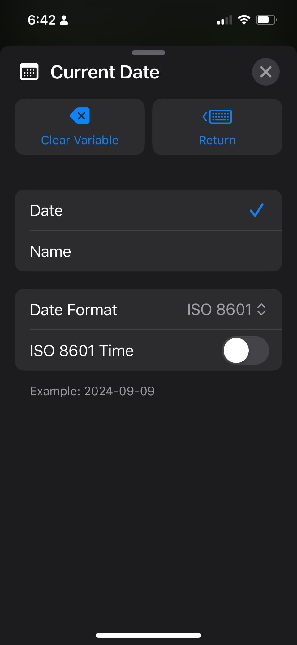

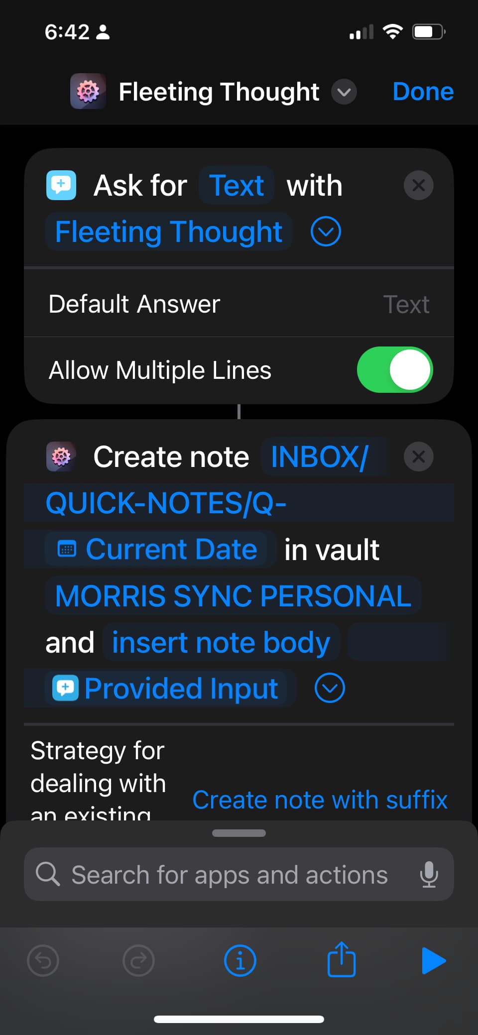

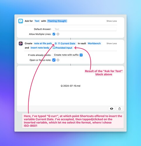

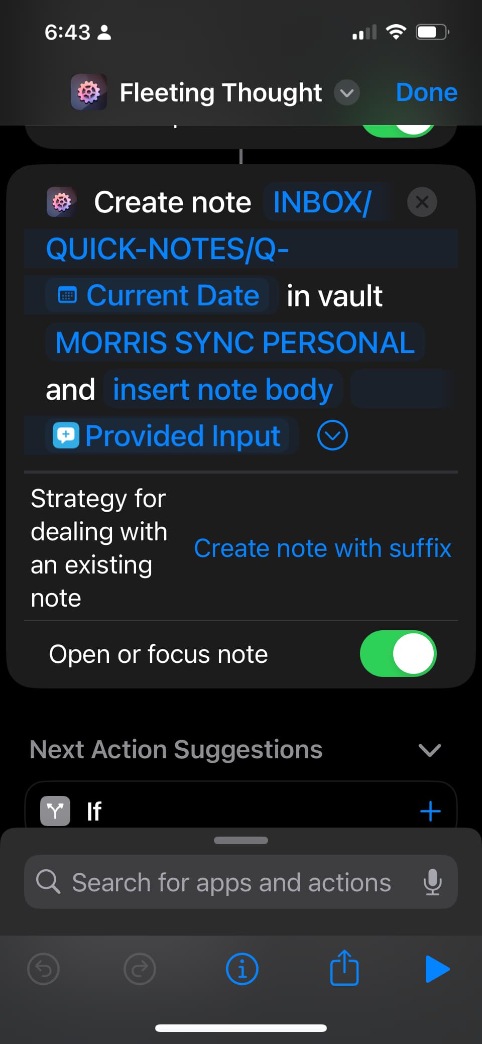

That said, using AFO, you can streamline this quite a bit – I suspect your Quick Add command just opens a new, blank note, right? In this case, why not have Shortcuts ask you for your fleeting thought right away, then create a note with the right name, at the right place, and the right contents:

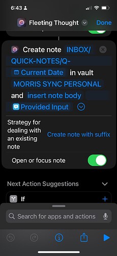

RE: Location of my Quick Notes—These are created in a folder at INBOX/QUICK-NOTES. I had this in the block originally, and it was placing the new quick note in the correct location, so will do the same with the above.
RE: Function of QuickAdd: Quick Note command. Yes, this is just creating a blank quick note using a template and naming it with the naming convention Q YYYY-MM-DD. IT then leaves it open and in focus ready for input.

Have had some time to play with this now. It is working all but perfectly. Only issue I have is that after it creates the note correctly, it switches to either a black screen again or opens the Actions for Obsidian app.
I tried adding a stop the shortcut action thinking it was still running, but this did not help.

However, after playing around more, I found the Open App [Obsidian] action, and I put that as the final action in my shortcuts and it solved the issue. Think this was doing what the pulldown was intending to do, but not sure if this is the right way or not. Not sure of any small differences between the two ways of doing this, but this way seemed to work. So, I have it working, and now its time to keep playing and see what else we can do. Thanks for the help!
