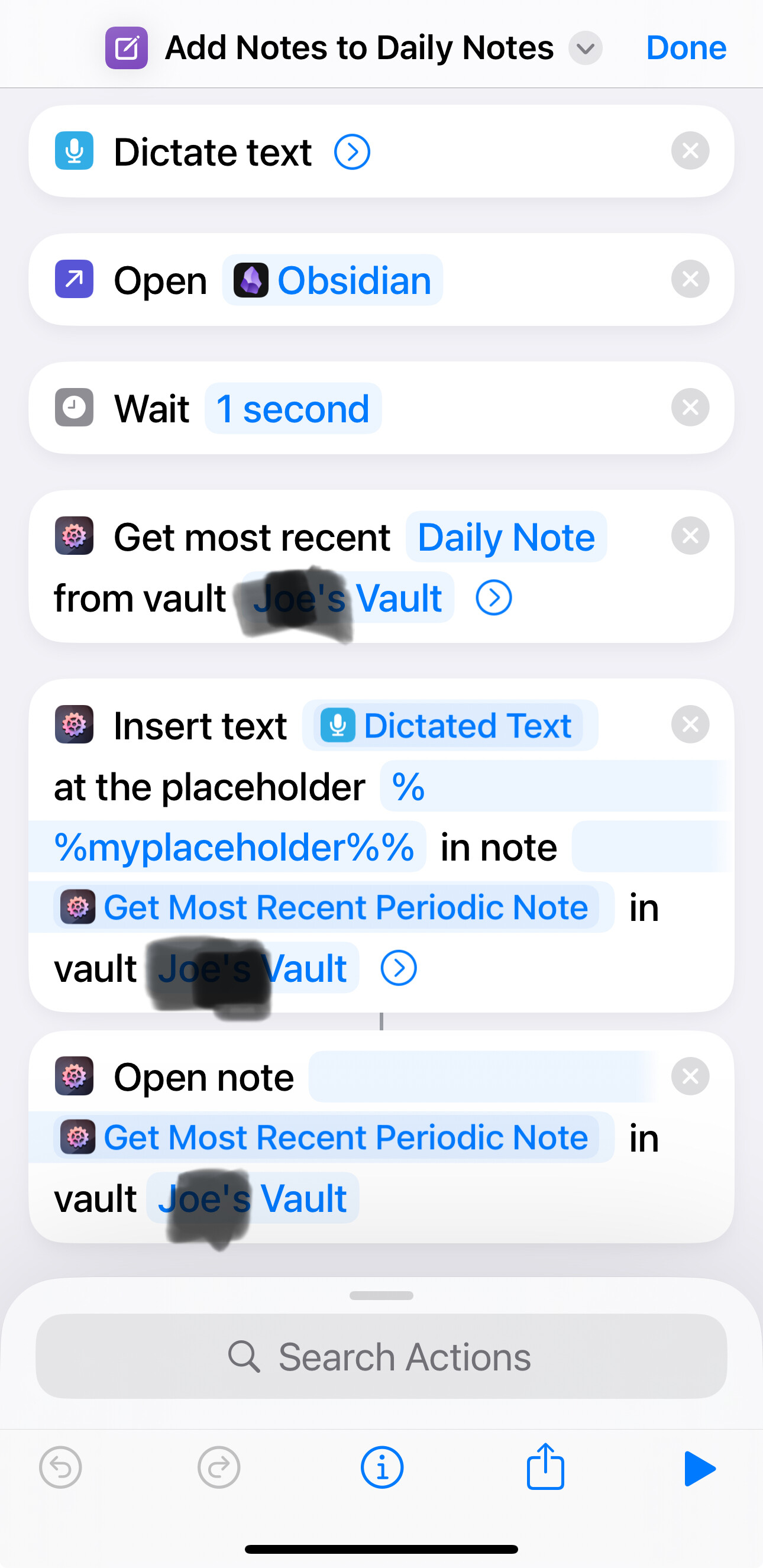

Hi , I have an error that has just recently cropped up in a shortcut that I created to insert text at a placeholder in my daily note using Actions for Obsidian. Up until recently it worked flawlessly. However, when I tried it today, I’m getting a dialog box asking what the file path is for the daily note. I have the daily note identified in the correct vault and so I’m in a loss.
As the shortcut runs, it correctly opens the most recent daily note (so it does “know” the correct file path relative to the vault). But my dictated text is never inserted at the placeholder and instead a dialog appears twisting the file path. The dialog box contains the following
What’s the file path of the note?

Hi @Joe_Girardot, welcome to the forum! It’s possible that you’ve run into an issue with iOS 18 beta, indeed, but unless I see the part of the workflow in question, I can’t tell for sure. Could you provide a screenshot, maybe?

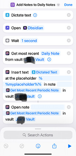

I’ve attached a screenshot here. I’ve obscured the vault name but it’s the same in all three locations
Thanks. I don’t see anything out of the ordinary here. Do you use iCloud Sync by any chance? Because I’ve heard of notes temporarily “vanishing” for a sec or two because iCloud Sync decided it needed to sync that file right now, hiding it temporarily in the process, and actions trying to access it in the meantime did fail.
Side note: Your workflow is a bit needlessly complicated, however, and could be simplified, which might change the outcome.
My guess is you actually want the current daily note, and not just the most recent one, is that possible? (Because Get Most Recent Periodic Note and Get Periodic Note do slightly different things.) If it is the current daily note you’re after, you can use the Periodic Note versions of these actions:
With them you don’t have to juggle the reference to a particular note:
If the issue persists, it might indeed be a problem related to iOS 18 beta, as there haven’t been AFO updates since.

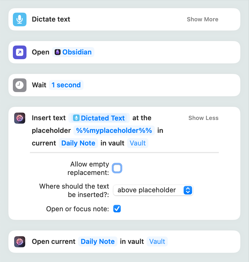

PS: Also, if you would be willing to help me debug in Obsidian, I’d be grateful.! It’d be as easy as installing another plugin of mine for a few minutes, running one of the failing shortcuts, and sending me the plugin output.

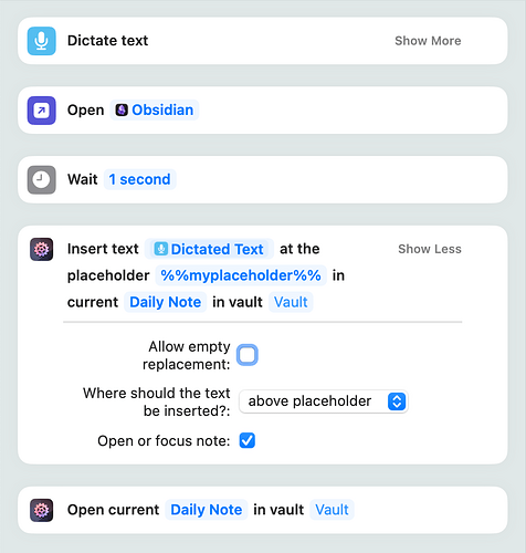

Happy to help debug! Here is the failing action
Obsidian (1.7.1) and AFO 2024.1.4 (6480) iOS 18.1, iOS 18 (final), MacOS last beta before final.
Thanks! I don’t see anything out of the ordinary. :thinking:
It’d be helpful if you could install my Logstravaganza plugin, enable it, restart Obsidian, then try the failing Shortcuts workflow. After it failed, disable the plugin again, and send me the resulting note via feedback mail so I can take a look.
Logstravaganza logs console output to a new note or text file. That note then reveals what Actions URI is doing, if there are any crashes or errors etc.

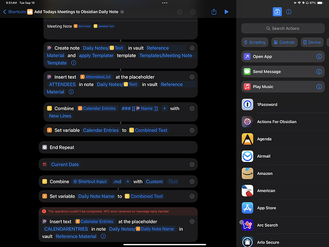

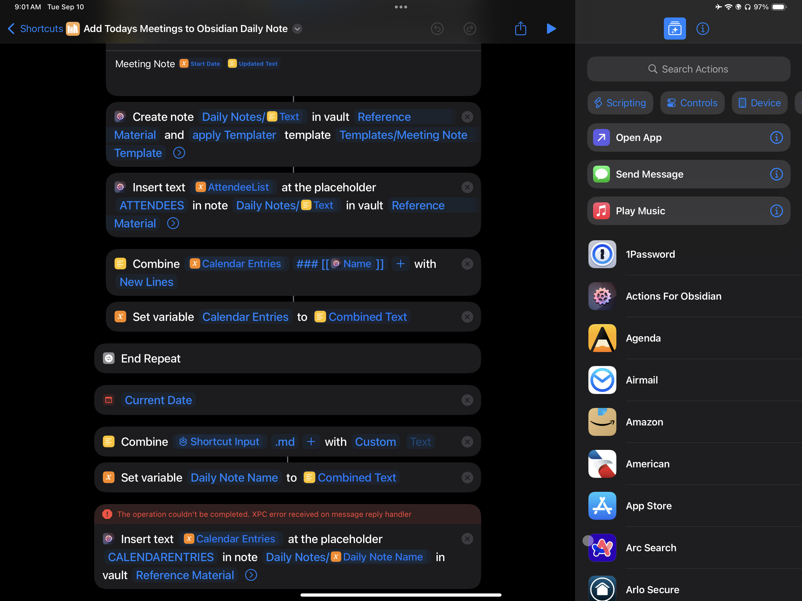

A post was split to a new topic: Bug report: Actions asking for File Path when working with note reference
