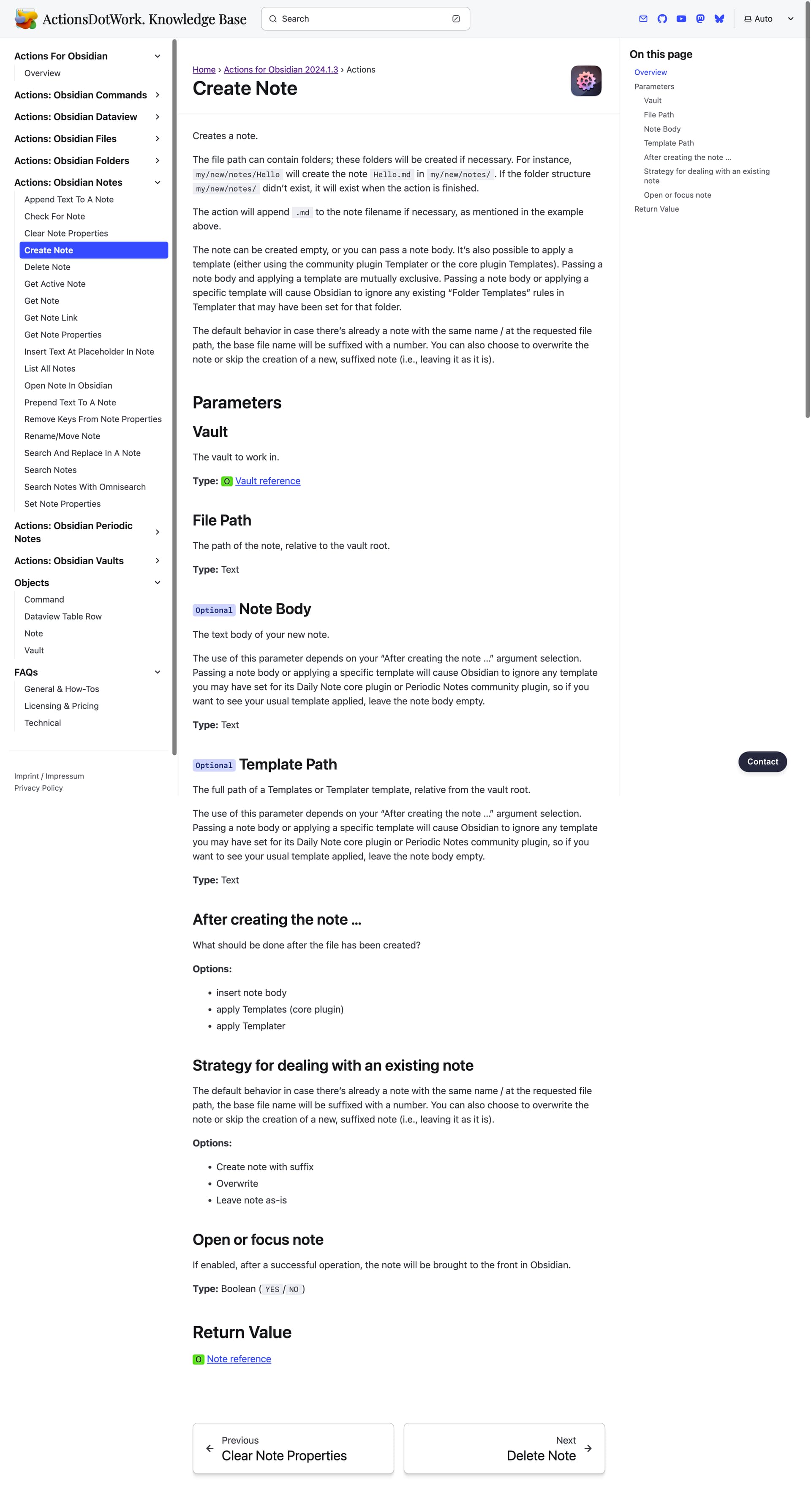

New Knowledge Base

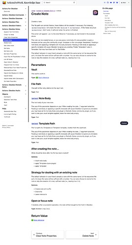

Those last two weeks I worked on overhauling the documentation for my apps, and over the weekend I’ve relaunched the entirely revamped Knowledge Base. I’ve tried to better document every single action, and also the custom objects that are passed between actions, like Actions For Obsidian’s Note snapshot/reference or UI Actions’ Running App snapshot/reference.
It’s a work in progress, and it’ll only grow over time. For example, my plan is to add links to the action docs pages, pointing to relevant forum posts or YT explainers (where applicable).
These efforts will reflect in the upcoming app versions – the biggest part of each page is generated from the in-app documentation, i.e. the intro, the parameters, and the result descriptions. I’m pretty happy with that setup!
What do you think? Any suggestions?
