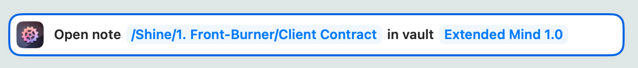

Hi Kara, first of all, welcome to the forum!
I think you can reduce your list of used AFO actions down to one:
Basically, just use that action and the Timery one. This will open the vault and open the note, assuming it exists. If it doesn’t exist, it will show a toast in Obsidian c/o Actions URI but it won’t stop your workflow. (Also, you can omit the .md in the path if you like, that’s implied.)
My guess is that there’s a slight discrepancy (maybe a typo) in one of your file paths so either the check is successful but opening the note fails or the check fails and there’s no attempt on opening the note. It’s a bit hard to debug from afar, I’m afraid.

I can get that to work on other file paths - not in this folder structure - so it is definitely something with the File Path name. I’ll keep working on that because ideally I’d like shortcuts for a number of different projects that do exactly the same thing and they all rest in this folder so figure out one and it’s simple to duplicate and repeat.
I was able to create and open the note /Shine/1. Front-Burner/Client Contract.md, so maybe there’s an extra space or something in the path, either the path of the actual note or the parameter in the action?
