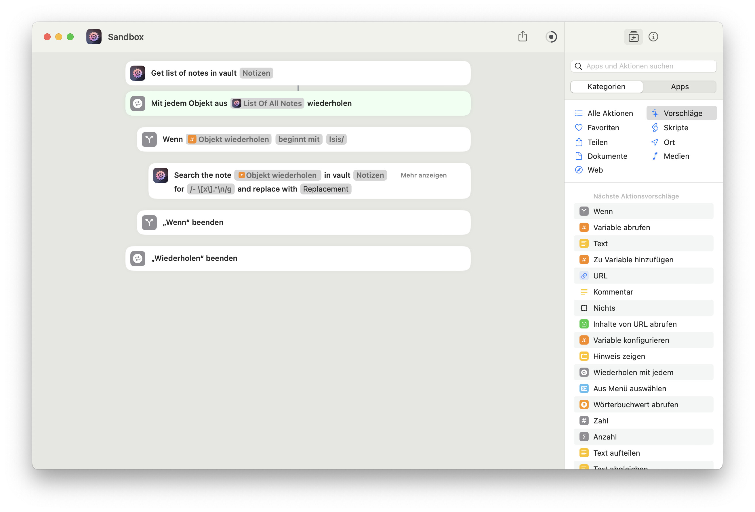

It works for a single note. My idea now would be to search and replace in all notes in one folder. How can I build a loop?

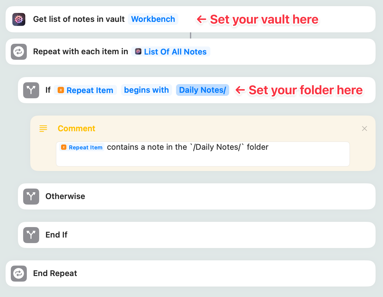

You have several options here. First, you can iterate over all files in your vault, and only work with those whose path start with a particular folder name:

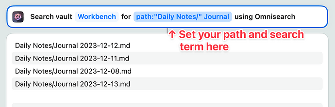

Also, you could use OmniSearch (see How to use Omnisearch for search syntax):
Here, I’ve omitted the “Repeat With” block for brevity, but Search Notes With Omnisearch returns a list of file paths which you can loop through.

Does it visibly hang at a particular step, or does it just run forever? If the former: Can you tell at which step it is hanging?
I guess my vault ist very large. The Action ist hanging on the second step.
Yeah, I guess the companion plugin exploded due to overload. I’ll take a note here, this shouldn’t just hang but communicate back.
I recommend the OmniSearch route, then, because it finds the applicable files in Obsidian before handing that list back to AFO, whereas Get List Of All Notes requests a list of all note paths from Obsidian, which seems to cause the problem you’re experiencing.
