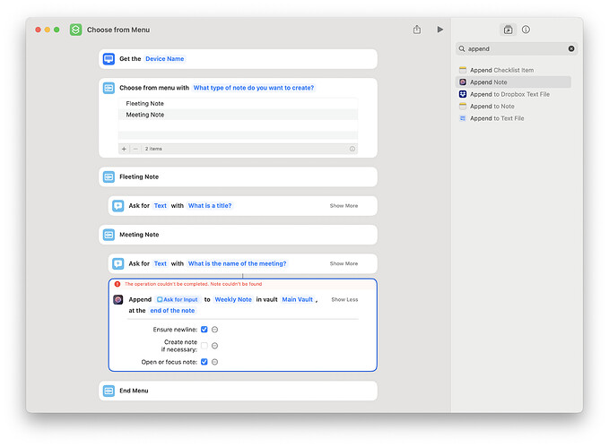

I’m not sure if it is an issue experienced by others, but I’ve been having trouble appending text to a weekly note using shortcuts. I’m able to append to daily notes just fine but an error is returned that the weekly note couldn’t be found. I do have a different naming scheme for my weekly note, through the Periodic Notes settings, but when using the periodic notes commands in Obsidian it retrieves the notes correctly.

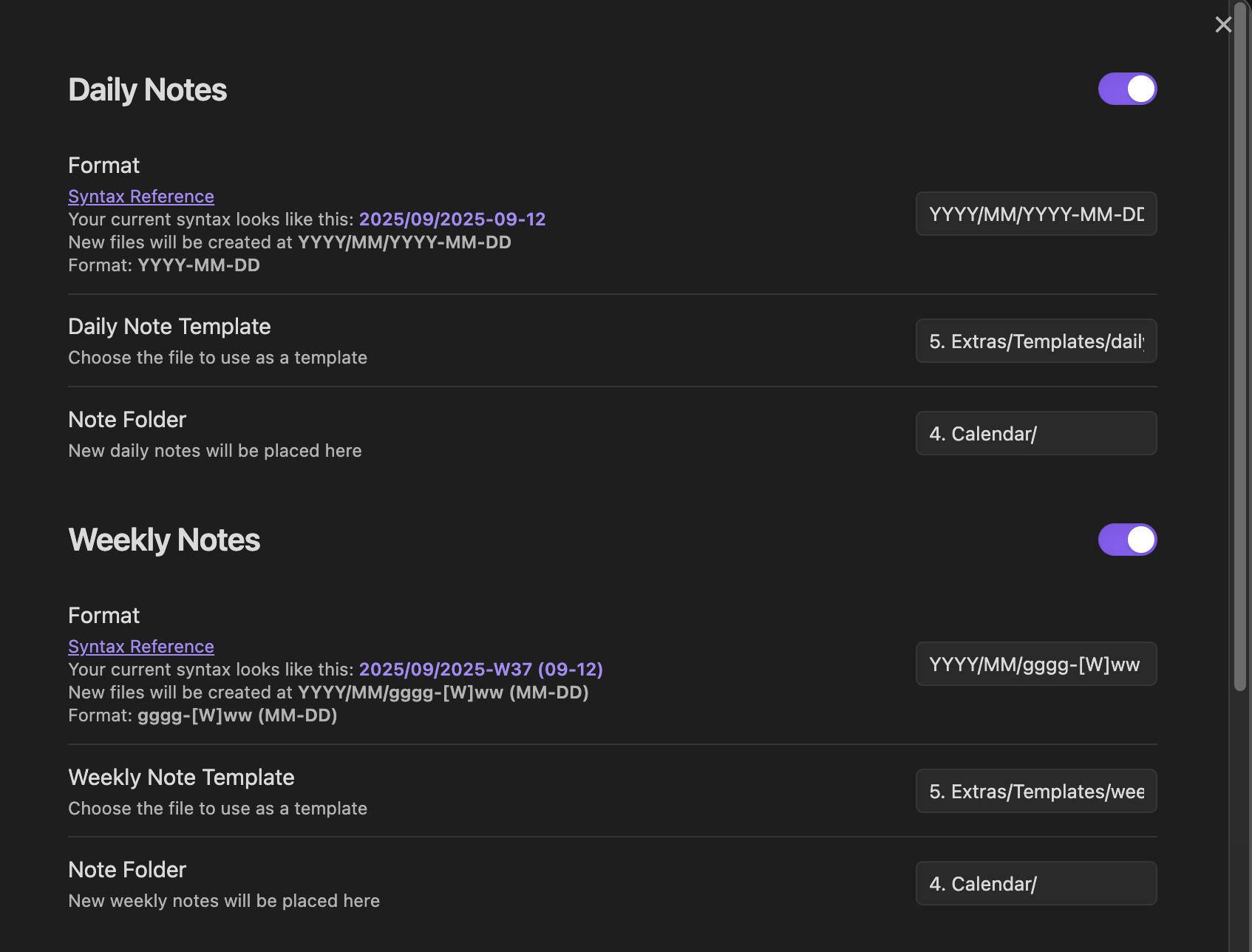

Could you please provide me with a screenshot of your Periodic Notes settings, please? And a shot of the Shortcuts workflow, too? If you don’t want to post them here in public, send me a private message instead.

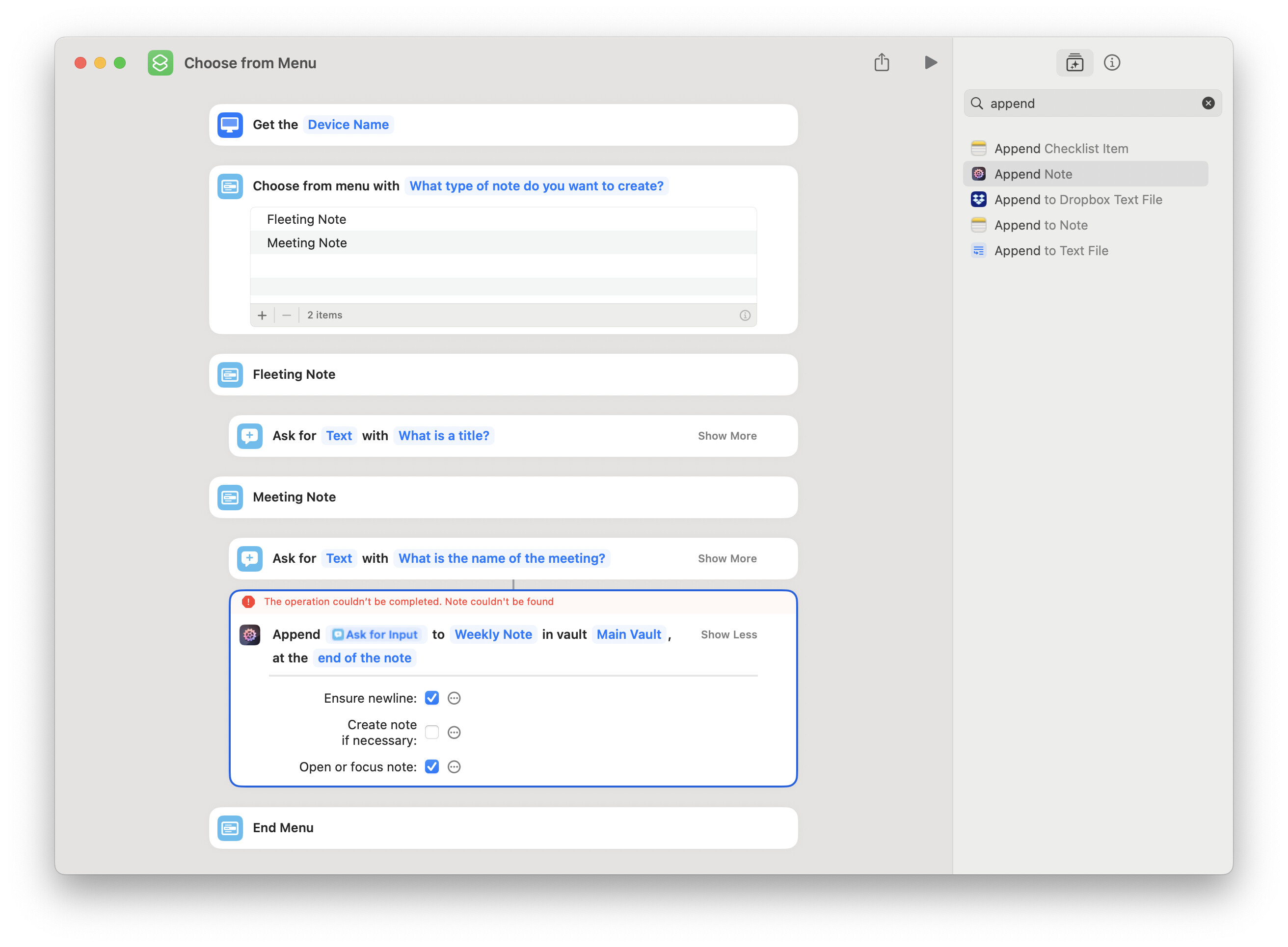

Here are the screenshots you asked for - starting out on the shortcut and was testing along the way so there isn’t much there yet.
I played around and had a few interesting things happen but without knowing behind the scenes I’m not sure if they’ll be helpful. The shortcut did seem to work with the “Daily Note” option. I tried the “end of note” and “end of section” options but neither worked.
When I tried to switch on the “Create note if necessary” option, the note it created was dated with the current day, 2025-W37 (09-12) instead of the note naming scheme that begins on Mondays (it should be 2025-W37 (09-08), but in other respects it was a weekly note (it applied my weekly note template).
When I tried to switch on the “Create note if necessary” option, the note it created was dated with the current day, 2025-W37 (09-12) instead of the note naming scheme that begins on Mondays (it should be 2025-W37 (09-08) , but in other respects it was a weekly note (it applied my weekly note template).

Thanks for troubleshooting. The weekly note syntax is: YYYY/MM/gggg-[W]ww (MM-DD). It is nested in a folder also indicated in the periodic notes settings: 4. Calendar/.

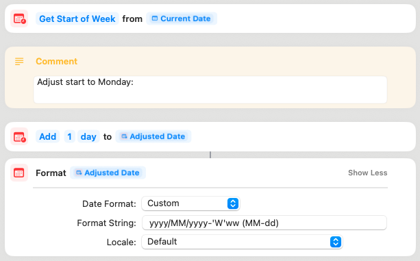

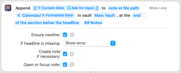

I was able to get a shortcut to work with my workaround, specifying the direct path. There might be a way to simplify it in shortcuts, but I formatted the date and then used the Append Note action as follows:
Prepare date:
Notes: Grabs the start of week, adds a day to begin on Monday, formats date.
Append note:
Notes: I added the calendar folder at the path here, but could have put it earlier.
Getting somewhere! It appears that the syntax MM-DD works differently in the Periodic Notes plugin and the aforementioned package that Actions URI is using to resolve the periodic notes. In the Periodic Note plugin, it means “first day of the week (Sunday or Monday, depending on your settings)”.
In the the liamcain/obsidian-daily-notes-interface npm package (again: same author as Periodic Notes itself!) the format is parsed in the “correct” way, i.e. the same way it works anywhere in Obsidian and everywhere else: DD is the current day of the month.
That means the “current weekly note” request in AFO worked well for me yesterday (a Monday, i.e. start of the week), and both Periodic Notes and the developer-focussed obsidian-daily-notes-interface resolved YYYY/MM/gggg-[W]ww (MM-DD)[1] to 2025/10/2025-W41 (10-06).md. But today it’s broken again, since Periodic Notes still returns the same computed path as yesterday while obsidian-daily-notes-interface resolves it to 2025/10/2025-W41 (10-07).md.
Good job! If you use that bit in several places, you could make it its own workflow that returns the path as a text, and call it like a subroutine from your main workflow(s).
