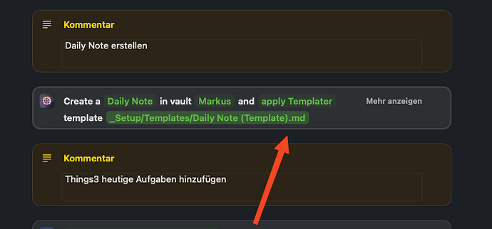

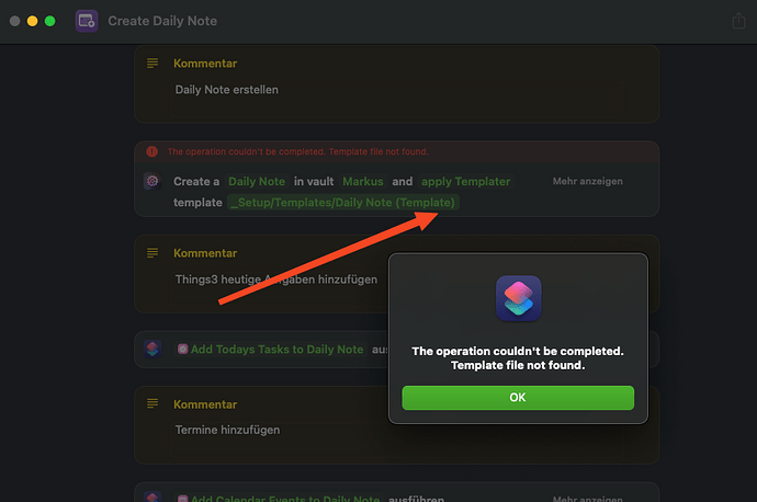

I just want to mention, that I had to change my path to my templates. I had to add “.md” to the path for my templater templates. Before it worked without this. Without the Extension the Action URI gives an error “template not found”.
@netfly This shouldn’t happen. I’m afraid I also have a hard time reproducing that issue here. Could you give me more details, please? Like, what’s the path to your Templater template folder, the name of the template you want to use, and maybe a screenshot of the action in the Shortcuts editor.
The path to my daily note template is “_Setup/Templates/Daily Note (Template).md” … but in the shortcut I used it without “.md” at the end and it worked until the last update. Now I had to add the extension.

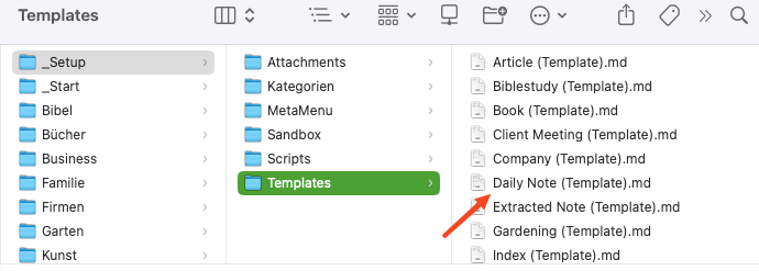

Thanks. Still works in my tests but I just remembered that I ran into this problem months ago – and it turned out I had accidentally named my template whatever.md.md. Obsidian would show it as whatever.md because it hides the .md extension so I didn’t notice right away.
Could this be the cause?

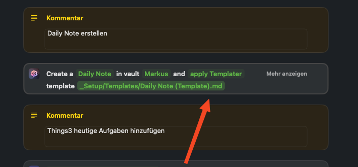

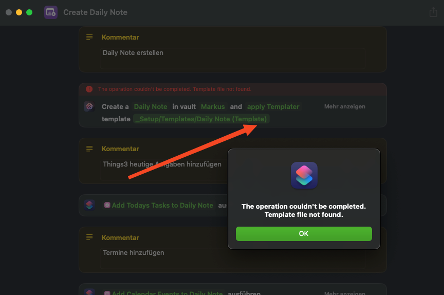

As you see, the file has no double extension … and in the second screenshot I removed the “.md” from the path and it didn’t work anymore. When I put it back it works again.
