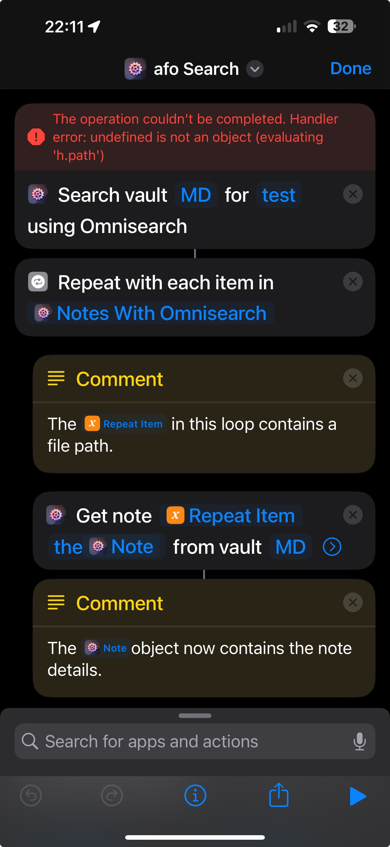

Hey, I was looking at the example here https://support.actions.work/article/98-notes-search-notes-with-omnisearch and tried to run it locally on my iPhone but it returns an error “The operation couldnt be completed… evaluating h.path” (or similar). See attached. Whilst I realise this is only an example, I did not expect it to fail?

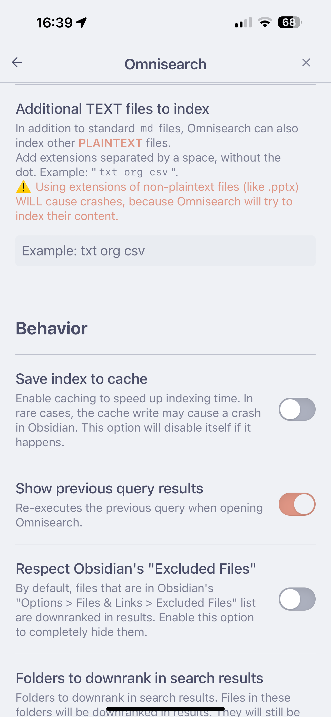

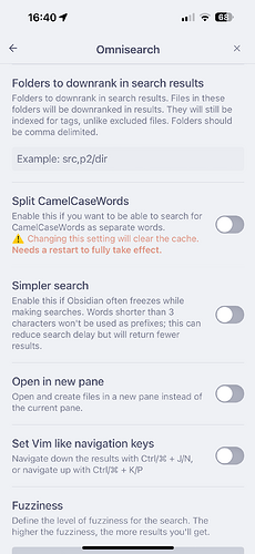

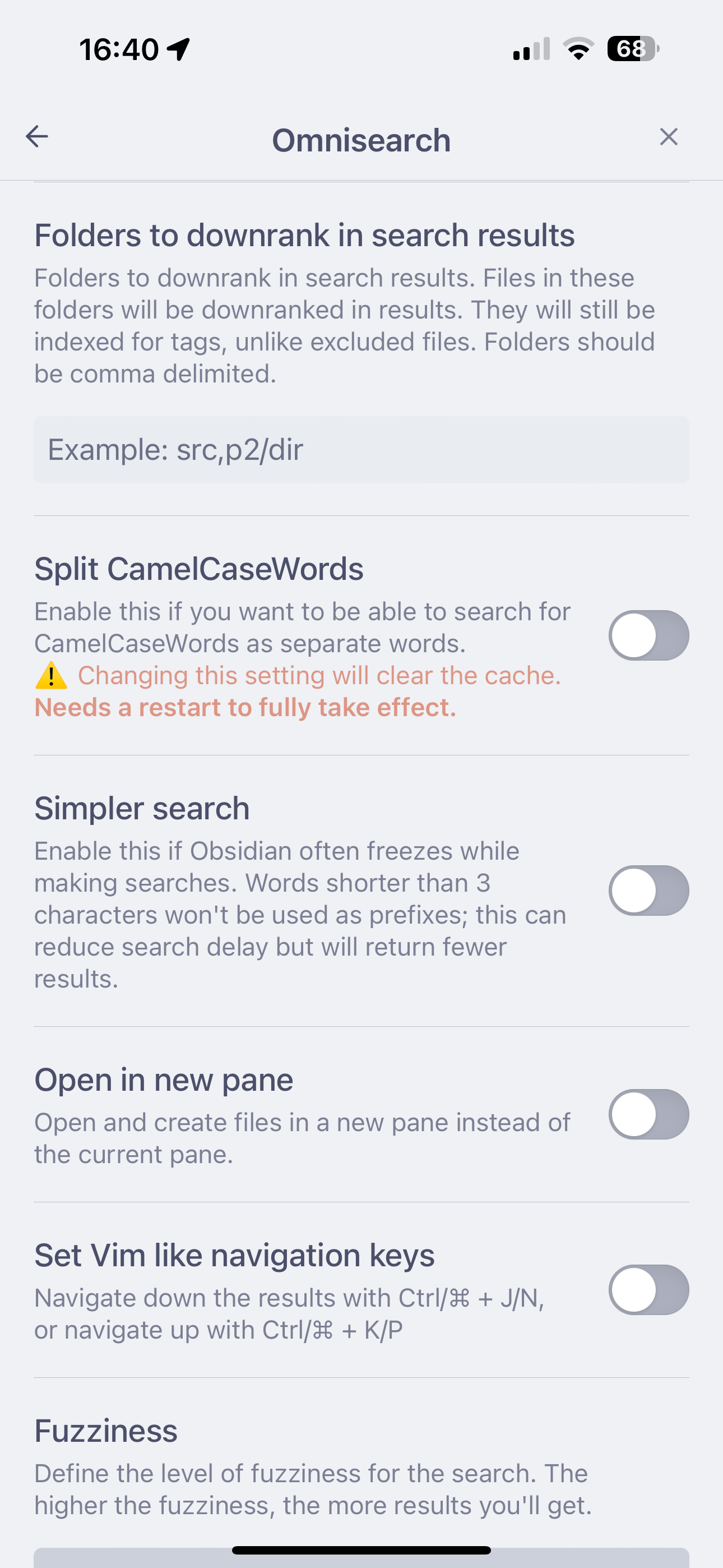

Also, what do the first two sections of your OmniSearch config look like (Indexing, Behavior)? It’s possible you’ve discovered a case I hadn’t dealt with yet.
Thanks for the pointer. I updated the OmniSearch plugin and now I do not get the error. However, whatever search term I give it, it cannot find anything. I will add my omnisearch settings.
Thanks

Ah, now I understand! Thanks for the screenshots! Your Get Note action is misconfigured – you pass the “Repeat Item” var as argument to the “at file path”/“with title” parameter; the repeat item is neither, so the action then asks for a valid argument.
Also, the fact that the workflow ends up there means that Search Notes With Omnisearch returned a list, otherwise the Repeat With block wouldn’t have been executed. Looks like nothing is broken, that’s good :wink:
