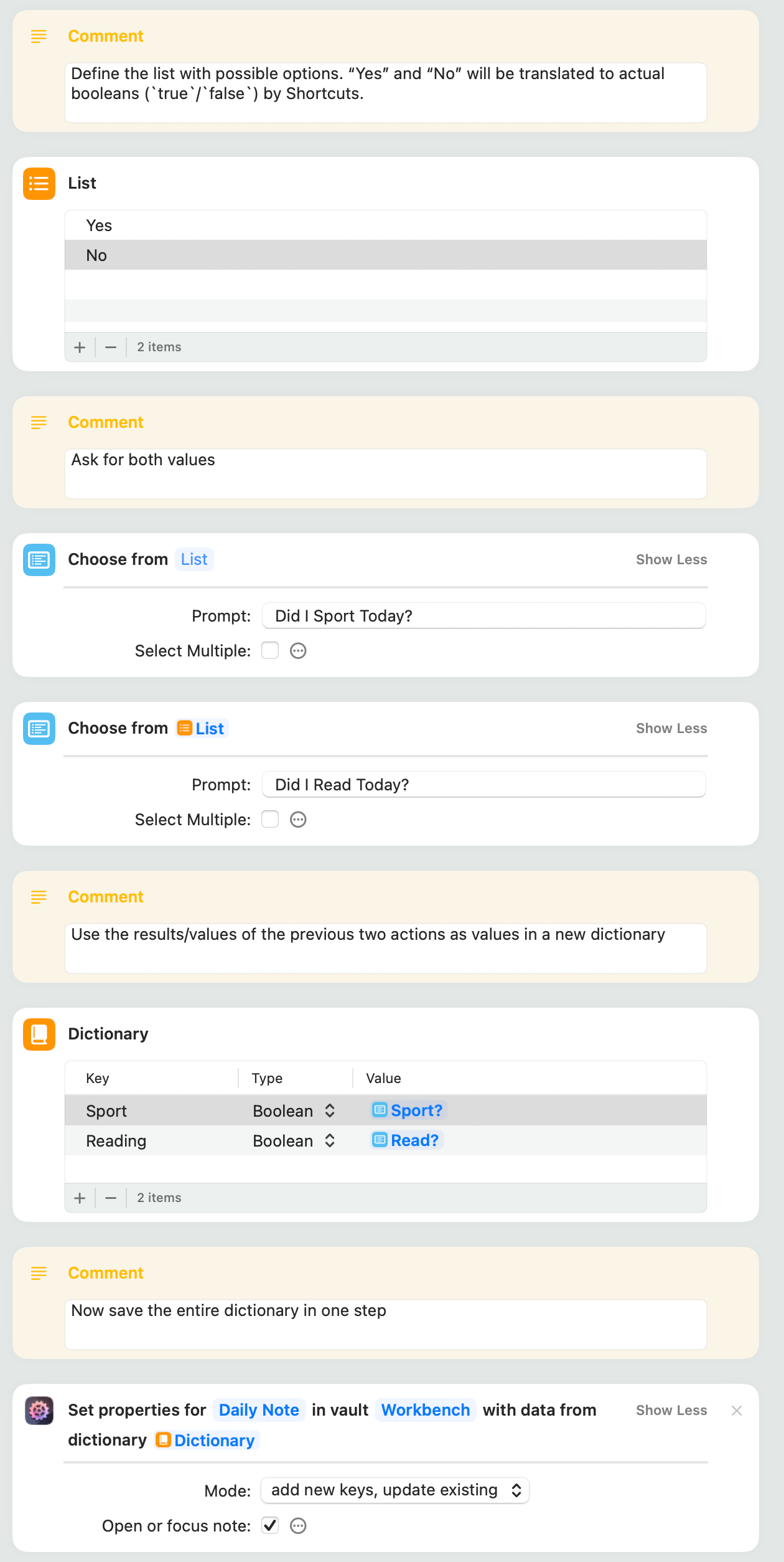

I’m struggling with my shortcut for the end of my day. I need to set two properties (Sport and Reading). The shortcut is working but I don’t think it is best practice how I’ve managed it. So I’m asking via a choose from menu the two questions: Did I Sport Today and Did I read Today? Now I’ve set every “set property for daily note” before every end of menu. So that means that the questions are separately processed and after finishing the first one it will ask me the second question, is it possible to first ask all questions and process them together.
See my shortcut

Yes, it is, you’re on the right track here! By combining the single results in one dictionary and then setting the properties of the DN once you can save quite a bit of back and forth. Here’s how I would go about the whole thing. I’ve added some comments so you’ll get an idea what’s going on:
And here’s the download: End of Day Daily Note.shortcut (22.5 KB)
Let me know if that does it for you :call_me_hand:t3:

This works great. Nice example for Set Properties in notes. Of course, this fails if the note does not exist, so you should use Check Note first to see if it’s available to set properties; if not, then you could Create Note, and follow the if block with Set Properties so it works whether the note exists or not (the if true branch would be empty, and only otherwise has Create Note). Also, I like how the action adds new properties at the end of any existing properties, rather than at the top. Examples like this are really helpful. Thanks.
P.S. You might mention that you use Select Variable to get the right List variable for each property in the Dictionary since that might not be obvious from just the screenshot.
