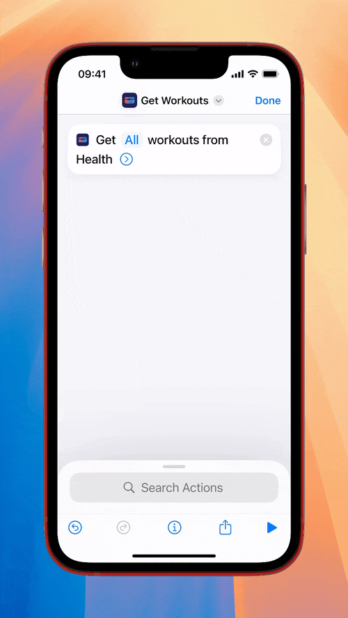

As far as I can tell, the Health app itself doesn’t surface that particular data type to Shortcuts. You’ll have to get a 3rd party utility like Toolbox Pro for that, which brings a dedicated Get Workouts action (among many other things, it’s a great app):
Bezel 2025-01-06 at 09.53.10
Update / PS: I don’t think iOS automation has a trigger for “workout finished” that would automatically run a workflow for you.

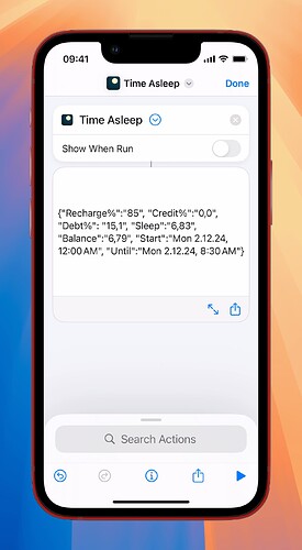

@LikeShootingStars There’s an app called AutoSleep which lets you export your sleeping times, maybe that helps?
