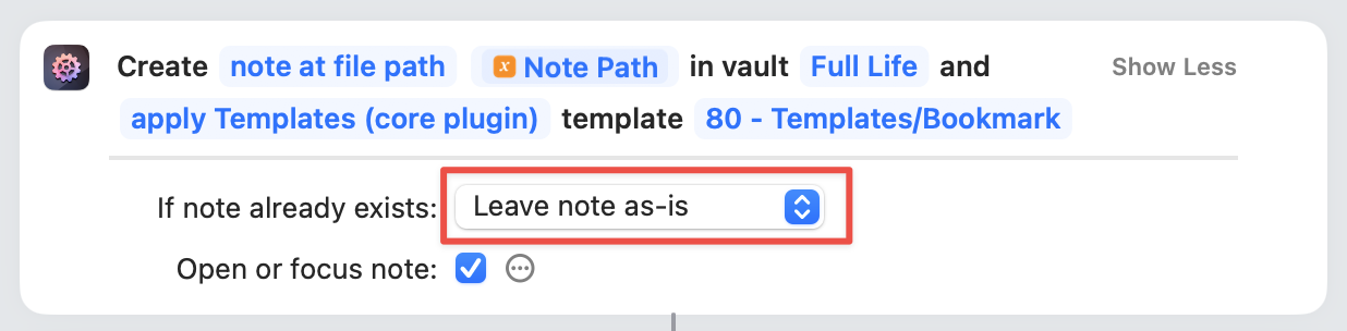

I have to manually add separate steps to the action to check for the existence of the daily note and create it myself if it does not exist.
The Create Note action has “If note already exists” option which can be set to leave the note alone if it exists, which means you don’t need to precede this block with a Check For Existence Of Note action:
If this is set, you can be certain the note in question exists once that block was executed. See the related documentation.

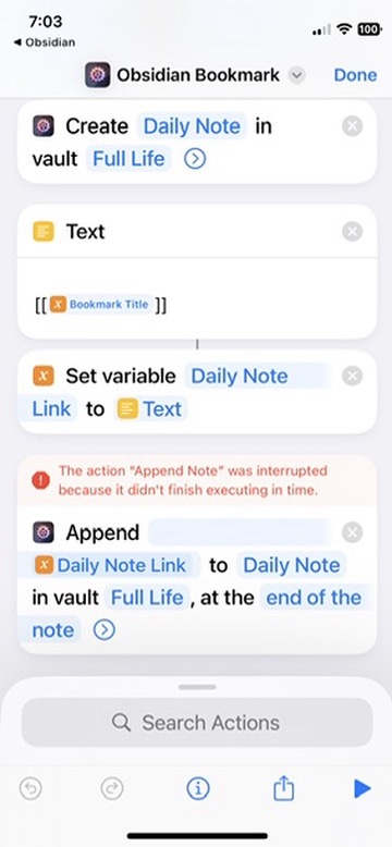

I just encountered an additional problem. On my iPhone (12 mini) I have iOS 18 and the same versions of everything I have on MacOS. Sometimes the AFO actions will fail due to timeout. It’s not very consistent. Sometimes it works, sometimes it doesn’t.
