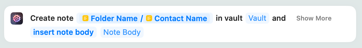

Im new to AfO and i also think that having strict file matching is great in a lot of contexts, however, it seems like you need to use one to create a new note? Im trying to create a note based on a template, and put that new note in a folder of similar notes based on the same template. I have tried a few different methods to do this but, for the life of me, I cannot figure out how to generate a unique file name for the new note in shortcuts. Ideally there would be a way to create a note within a folder, with the folder name and note name being separate variables.
For context my goal is to make a folder of hyperlinked contacts, where each note contains an individual’s contact info and bio based on a template.
Also plmk if this should be its own thread or has simple solution I’m missing.
Welcome to the forum, @Jdixswell! Good question, here are some options you have…
The easiest (and probably silliest) would be to set a “default” file name, like “Contact”, and use the Create Note’s “Strategy for dealing with an existing note” option to just add a numeric suffix. This way, you’d end up with notes named “Contact”, “Contact 1”, “Contact 2”, etc.
You can. Since the “File Path” parameter is just a text field, you can use multiple variables in there as you can in any text field (the two vars here, Folder Name and Contact Name, are placeholders for your own variables):

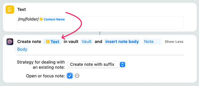

Another approach would be to build your file path in a Text action, and use the result of that action as the input parameter for Create Note’s “File Path”:
Does that help you?
