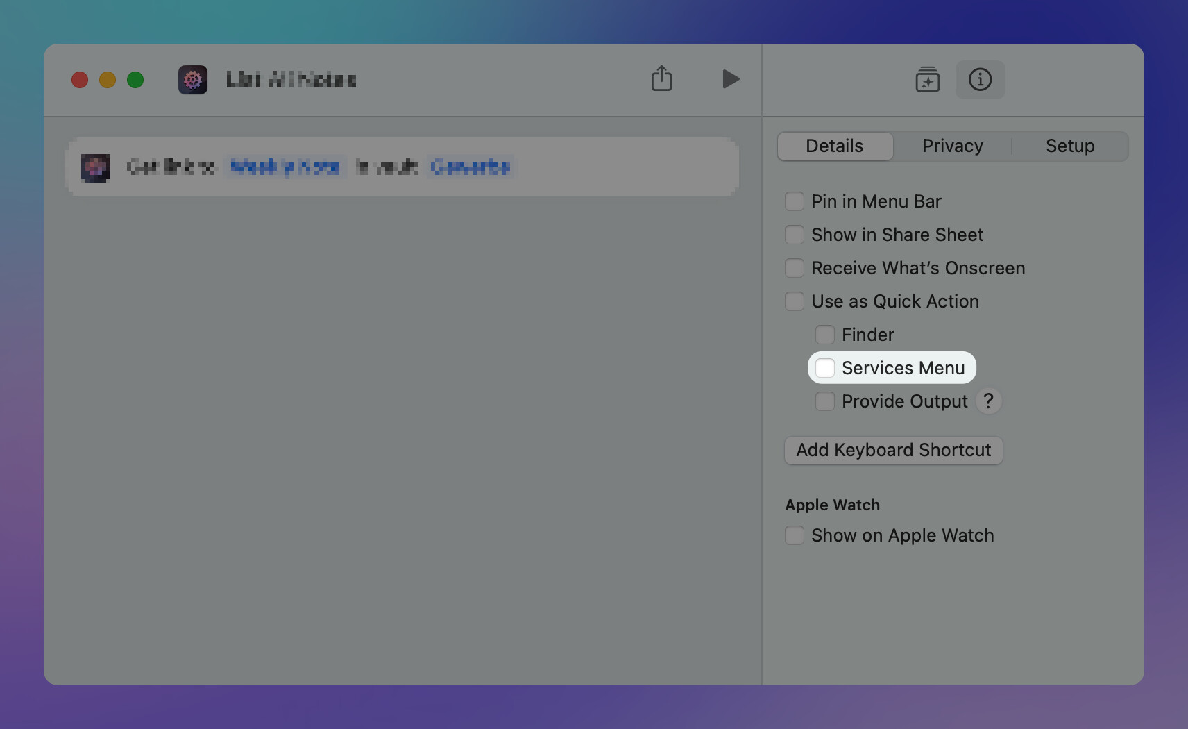

Welcome to the forum, @realize! Adding Shortcuts workflows to the Services menu is nothing that is special to Actions For Obsidian, or Obsidian – you can make any workflow show up in Services by checking this toggle:

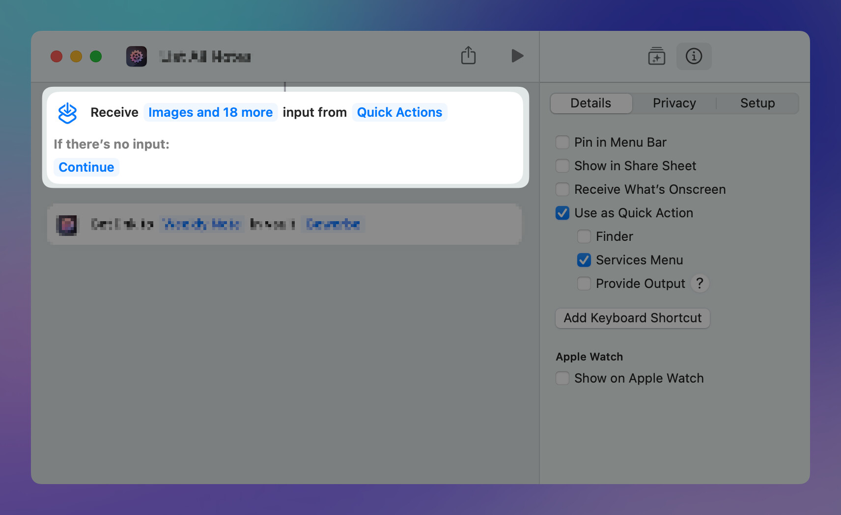

If you do, this’ll add this input parameter configuration to the workflow which lets you specify for which types of input (text, images, URLs, PDFs, etc.) the workflow should be shown in the Services menu:

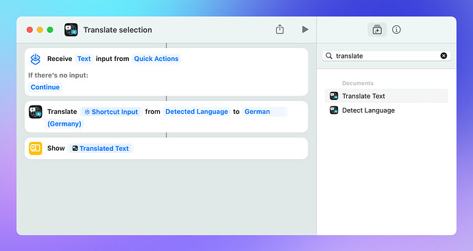

seems it does! Thank you. Can I assume then it’s just a matter of locating, for instance, the “translate” OS functionality, and it will show up in the Obsidian “services” menu?
Correct, like so:
