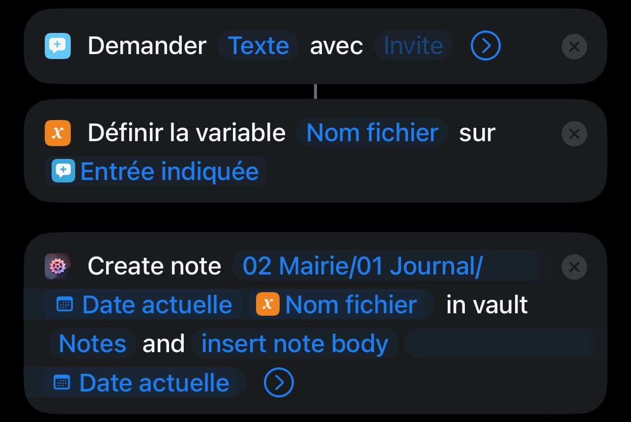

I created a simple shortcut, to create a new note in a specific folder (see attached screenshot)
When I use the shortcut, I have a prompt to type the file name.
Then, Obsidian open the new note.
Then, AFO opens.
I have to switch to Obsidian to edit my note.
Nicolas

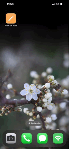

![RPReplay_Final1715887154](https://forum.actions.work/uploads/db2626/original/1X/b942a0bcc24e05c9f11c384f32fee716f686676a.gif)
Here is a screencast of my issue.
I configured AFO to do nothing …. But AFO is displayed after the action
As described in the FAQ page I’ve linked?: There’s a setting for that, and your screencast actually shows it, too – open AFO, go to the Settings tab, and set the “End of workflow” option. Currently, according to the animation, it’s set to “Do nothing”, which is what AFO is doing right now ![:wink: :wink:](https://forum.actions.work/images/emoji/apple/wink.png?v=12)

![RPReplay_Final1715939829](https://forum.actions.work/uploads/db2626/original/1X/5ed21d98b4d103268b1c8bb4c9a4bf2d9b3bf0bb.gif)
Thanks! Glad to see it’s not broken ![:sweat_smile: :sweat_smile:](https://forum.actions.work/images/emoji/apple/sweat_smile.png?v=12)
But it opens obsidian twice …
Yes, unfortunately, this is to be expected. As mentioned, the type of Obsidian’s API will make iOS open the app for every API call (bringing it to the front), and there’s nothing anyone can do about it.
Returning info back to AFO uses the same API, naturally, and iOS/Shortcuts will bring AFO to the front.
So, what you’re seeing here is the following:
- AFO pinging the Obsidian API with the request to create the note → Obsidian opens.
- Obsidian returning the “all done” info back to AFO → AFO opens.
- AFO, after figuring out that the workflow is finished, opens Obsidian again.
I wish there was a way to skip the last two steps but since AFO needs to know whether the note creation was successful or not, Obsidian will need to call it back.
