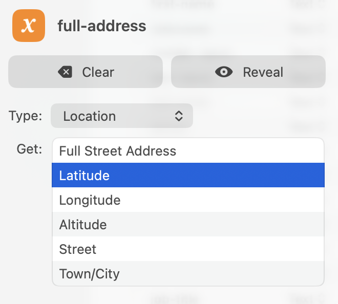

  1. Get the address from contact and save in a variable (e.g. ‘full address’)
  2. Then, from that variable, get longitude and latitude:
  1. Last step is to save both (first latitude and then longitude) into a property which you can then reference in the bases

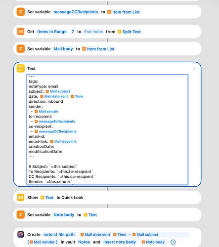

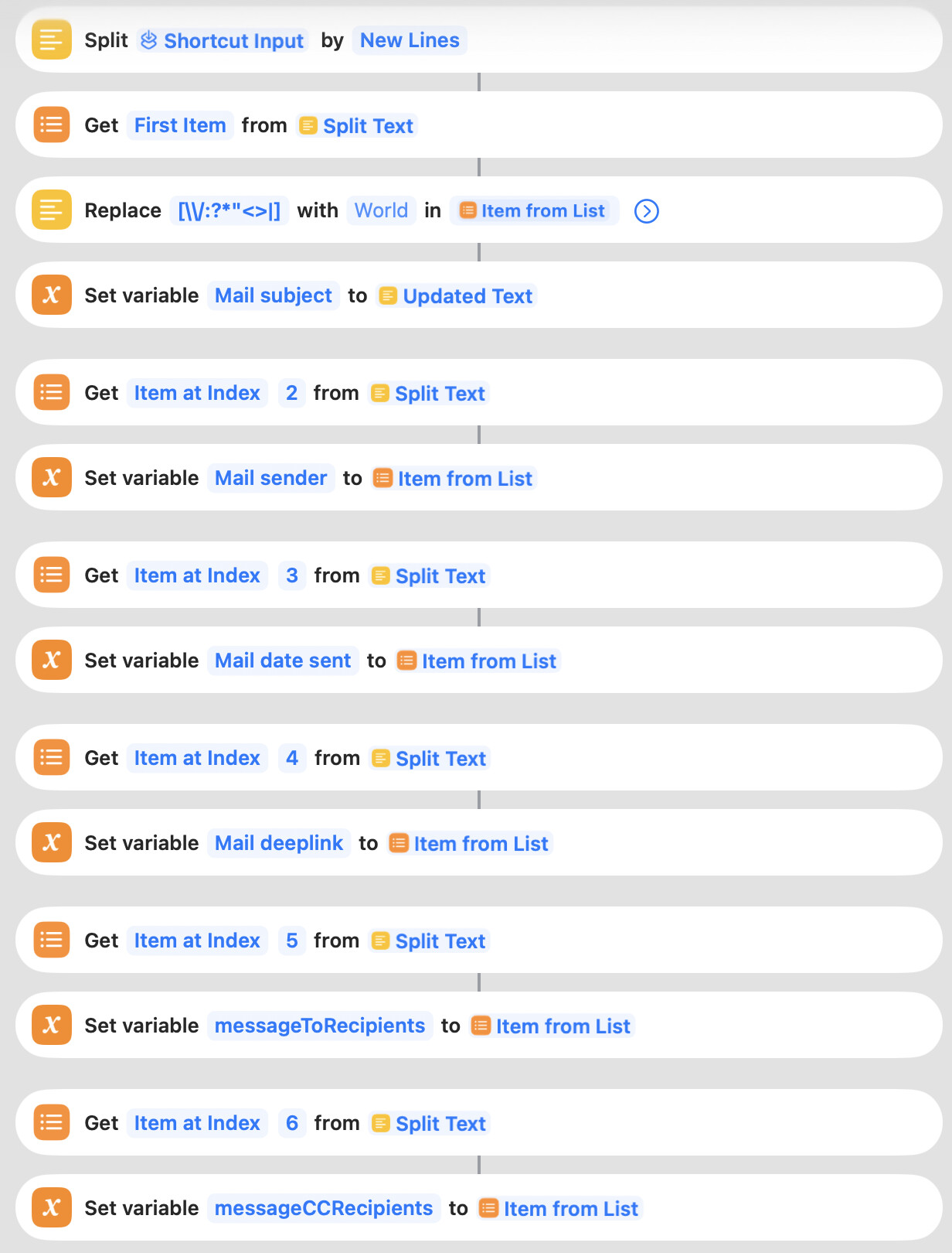

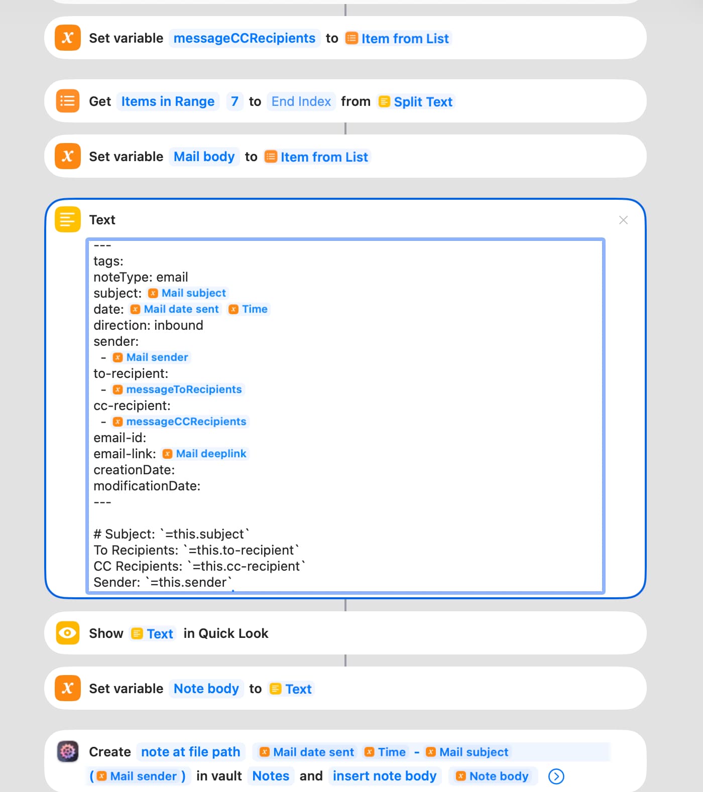

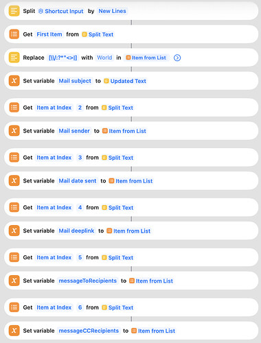

I have expanded your original Email to Note script a bit to include “sender”, “to-recipient”, and “cc-recipient".
This is then picked up in Shortcuts and the most of the meta information filled into the note properties:
These properties are the referenced in the note body to have a clean display while being able to query the meta data easily.
My question is then the following: How can I replace an email address (be it sender, to recipients, or cc recipients) with a link to a person’s note.
The desired behaviour is for the email address to be replaced with a link to a note followed by the email address e.g. john@doe.com becomes “[[John Doe]] (john@doe.com)”. And the fallback for people, I don’t have a contact note for, to simply stay the email address.

Do you want that to happen in the note body so that it’s visible in preview? Because that might be doable dynamically, using Dataview (as in: “find note w/ email address, then output a link to that”). “Hardcoding” the link in the note itself (body or front matter) will be way more involved because you’d have to rewrite the note at creation/modification, but you know that :sweat_smile:

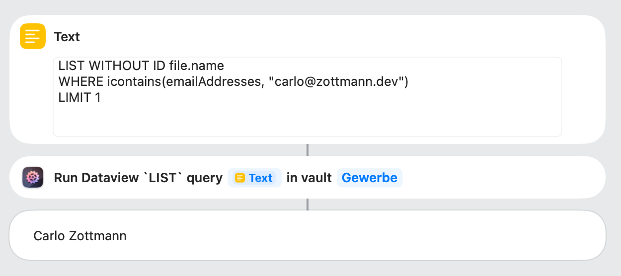

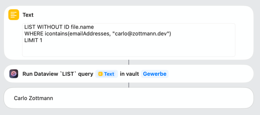

But since we’re already talking about Dataview (well, I am), if Dataview is an option for you,then there’s the Get Dataview List action. When you gather all your variables, before you compile the final note body, you could add a DV query in the mix to fetch the right contact note. Assuming the contact note contains email addresses like this:
emailAddresses:
  - "carlo@zottmann.dev"
  - "carlo@zottmann.org"
… then this DV LIST query:
LIST WITHOUT ID file.name
WHERE icontains(emailAddresses, "carlo@zottmann.dev")
LIMIT 1
… would return that note’s title (= contact name). Set it up like this:
Save the output of the Dataview action in a variable, if the var’s empty afterwards, there’s no related contact.
Does that help?

The action shown in my last post would return the name of the note, i.e. the name of the contact, which you might then use to create a wiki link in your new note body. So the new note would contain a link back to the sender’s contact note. I guess this line:
Sender: `=this.sender`
… would then become:
Sender: [[<Sender name>]] (<Mail sender>)
(The <…> are the variables you set earlier.)
That said: Dataview can also return a composed string, e.g. "[[<Sender name>]] (<Mail sender>)". Change the DV query to this:
LIST WITHOUT ID "[[" + file.name + "]] (" + firstvalue(emailAddresses) + ")"
Compared to the initial DV query, this does more: It finds the note that contains the passed-in email address, and returns the name as a link followed by the first email address from that note in parentheses. Also, the “LIMIT 1” is removed so it’ll return a list of those strings (instead of just one) – good for your “to:” and “cc:” lists.
So that could work. The only thing I see that might be an issue is that you’d either have to run that action for every single email address in that incoming mail or you’d run it once for every header type (“to:”, “from:”, “cc:”) but for that to work you’d have to get creative in the DV query because it’s “WHERE” clause only checks for one address right now.
